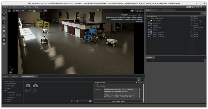

Isaac Sim 5.0 ROS2 Navigation doesn't work with ROS2 Jazzy on Ubuntu 24.04 with latest updates
Isaac Sim Version
5.0.0
Operating System
Ubuntu 24.04
GPU Information
  • Model: RTX4080 - Nvidia founder’s edition
  • Driver Version: Now back to 570.195.03, tried 580 which was worse (adding CUDA errors)
Topic Description
I have run Isaac Sim 5.0 successfully on the same system when enabling ROS2 humble libraries and running ROS2 humble using Docker. But enabling Jazzy libraries and following all your instructions doesn’t work with native (non-Docker) ROS2 Jazzy.
Detailed Description
The PC has a Core i9 14th gen, 64GB, with RTX4080. Isaac Sim compatibility checker shows it’s ok (result screenshot copied below). After starting Isaac Sim 5.0 with Jazzy libraries I load the unmodified ROS2 multirobot Navigation example, for example the Hospital scene. Then I hit play in Isaac Sim. But when I run ROS2 Jazzy natively I get error messages and RVIZ doesn’t show the keepout zones. If I exit out of Isaac Sim, enable Humble libraries, and run ROS2 Humble from Docker, it works as expected.
I have seen and followed all the instructions here:
I then reinstalled Isaac Sim 5.0, reinstalled ROS2 Jazzy, reinstalled the workspace, used the instructions to rebuild the workspace in Docker for the Python 3.11 issue, but it still works only with Humble libraries with ROS2 Humble through Docker and not with Jazzy libraries and ROS2 Jazzy without Docker.
Steps to Reproduce
  1. Install Isaac Sim 5.00 and Isaac Sim 5.00 compatibility test. (Note I installed Isaac Sim 5.0 to a folder named isaacsim_5.0 instead of just isaacsim because I also have 4.5 and 4.2 on the same system)
  2. Run Isaac Sim 5.0 compatibility test: results are ok, see below
  3. Install ROS2 Jazzy and the additional dependencies (ros-jazzy-vision-msgs, ros-jazzy-ackermann-msgs, python3-rosdep build-essential, python3-colcon-common-extensions)
  4. Clone the Isaac Sim ROS Workspace Repository from isaac-sim/IsaacSim-ros_workspaces.
  5. Standard workspace setup:
source /opt/ros/jazzy/setup.bash
cd jazzy_ws
git submodule update --init --recursive
rosdep install -i --from-path src --rosdistro jazzy -y
colcon build
cd jazzy_ws
source install/local_setup.bash
  1. following instructions for Python 3.11 compatibility:
cd IsaacSim-ros_workspaces
./build_ros.sh -d jazzy -v 24.04
In a new terminal:
source build_ws/jazzy/jazzy_ws/install/local_setup.bash
source build_ws/jazzy/isaac_sim_ros_ws/install/local_setup.bash
export ROS_DISTRO=jazzy
export isaac_sim_package_path=$HOME/isaacsim_5.0
export RMW_IMPLEMENTATION=rmw_fastrtps_cpp
export LD_LIBRARY_PATH=$LD_LIBRARY_PATH:$isaac_sim_package_path/exts/isaacsim.ros2.bridge/jazzy/lib
export FASTRTPS_DEFAULT_PROFILES_FILE=/home/user/IsaacSim-ros_workspaces/jazzy_ws/fastdds.xml
$isaac_sim_package_path/isaac-sim.sh
In Isaac Sim, Window → Examples → Robotics
then in the Robotics Tab: ROS2 → NAVIGATION → MULTIPLE ROBOTS → Hospital Scene → Load Sample Scene.
Loads ok, viewport shows 3 robots in the hospital lobby. Then press play.
  1. In a new terminal:
cd ~/IsaacSim-ros_workspaces/jazzy_ws
ros2 launch carter_navigation multiple_robot_carter_navigation_hospital.launch.py

Thanks for bringing up this issue. Let me reach out to the internal team.
But based on the error message, it looks like you have python3.12 installed but Isaac Sim 5.0 requires python 3.11.
Could you please check your python version in your environment?

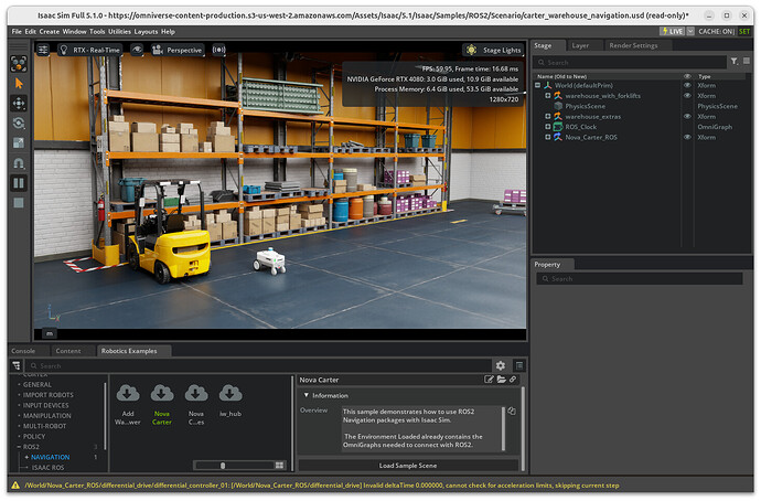

Thanks very much for the notification that Isaac Sim 5.1 is now stable. I followed the installation steps exactly, except for naming the folder isaacsim_5.1. In the selector I enabled the ROS2 bridge and as a first experiment I selected the humble library, which worked with Isaac Sim 4.2, 4.5, and the developer pre-release of 5.1.
I tried the Kaya example, it worked.
Then I tried the ROS2 navigation → multiple robots → hospital, and the Nova Carter robot looked distorted. I had seen that in previous versions of Isaac Sim before, but in those cases the issue resolved itself as soon a I clicked on Play for the first time. However, now with the stable 5.1, the issue is still there and now clicking on Play doesn’t fix the appearance of the Nova Carter robot. I also tried the warehouse scene, same result. Please see screenshots below. The title at the very top of the simulation screen confirms this is Isaac Sim 5.1 and referencing Isaac Sim 5.1 assets through AWS.

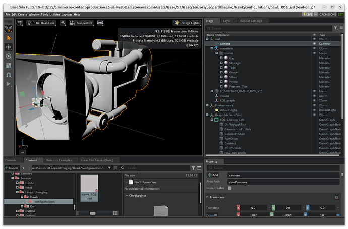

So it looks like there may be an asset mismatch of some kind ? I did use the clear caches script and tried again, same result.
Note that all of this is before even starting any version of ROS2. And starting ROS2 humble did seem like it wanted to make the Nova Carter robot move, but it seemed confused.
This also happened in the Isaac ROS2 → Isaac ROS -Sample Scene. Again, this was without even starting Isaac ROS or ROS2 in additional windows, just Isaac Sim 5.1 by itself and even after clearing caches.
Then I clicked on those odd protrusions from the Nova Carter robot and found those items are cameras, somehow in disproportionate scale to the rest of the scene. I then selected each one of the cameras and scaled them down manually to 0.1, and that fixed the appearance
So in summary Isaac Sim 5.1 seems to have some kind of asset mismatch in the cameras of the Nova Carter robot model in the Isaac Sim 5.1 assets on AWS.
I then clicked on one of the protrusions and pulled it out of the Nova Carter model and found it looks like an old fashioned video camera. I have not modified any files, don’t know where this shape came from
Then I investigated further by clicking on that item and “open in content browser” by itself. Interesting results, there are duplicate meshes for the camera:
So then if I click on the eye icon to make the highlighted item invisible, that extra camera shape disappears and we’re left with the correct mesh for the LI Owl
That’s as far as I can investigate this. Maybe this can help the dev team to fix the appearance of the Nova Carter robot, or anything that has those cameras. The Carter V1 is not affected but you don’t have a ready made ROS2 navigation example for it.
So this issue prevents proper testing with ROS2 in both the single robot and multi robot Navigation scenarios.
Looks like perhaps a simple fix in the Isaac 5.1 assets for ROS cameras ?

Then at the top of the GUI, I select Window → Examples → Robotics Examples.
In the Robotics Examples tab, I select ROS2 → Navigation → Nova Carter and then I load the scene.
Then in a new terminal window:
cd jazzy_ws
source /opt/ros/jazzy/setup.sh
colcon build
source install/local_setup.sh
ros2 launch carter_navigation carter_navigation.launch.py
and I get an RVIZ display that is almost correct, and looks like it has a functioning Lidar, but no costmap
If I use ROS2 Jazzy from Docker, I get the exact same results.
If I use ROS2 Humble from Docker, it works.
The documentation says Jazzy is fully supported in Isaac Sim 5.1 on Ubuntu 24.04, so please let me know what I should try or if I have anything wrong in starting Isaac Sim or launching ROS2.
