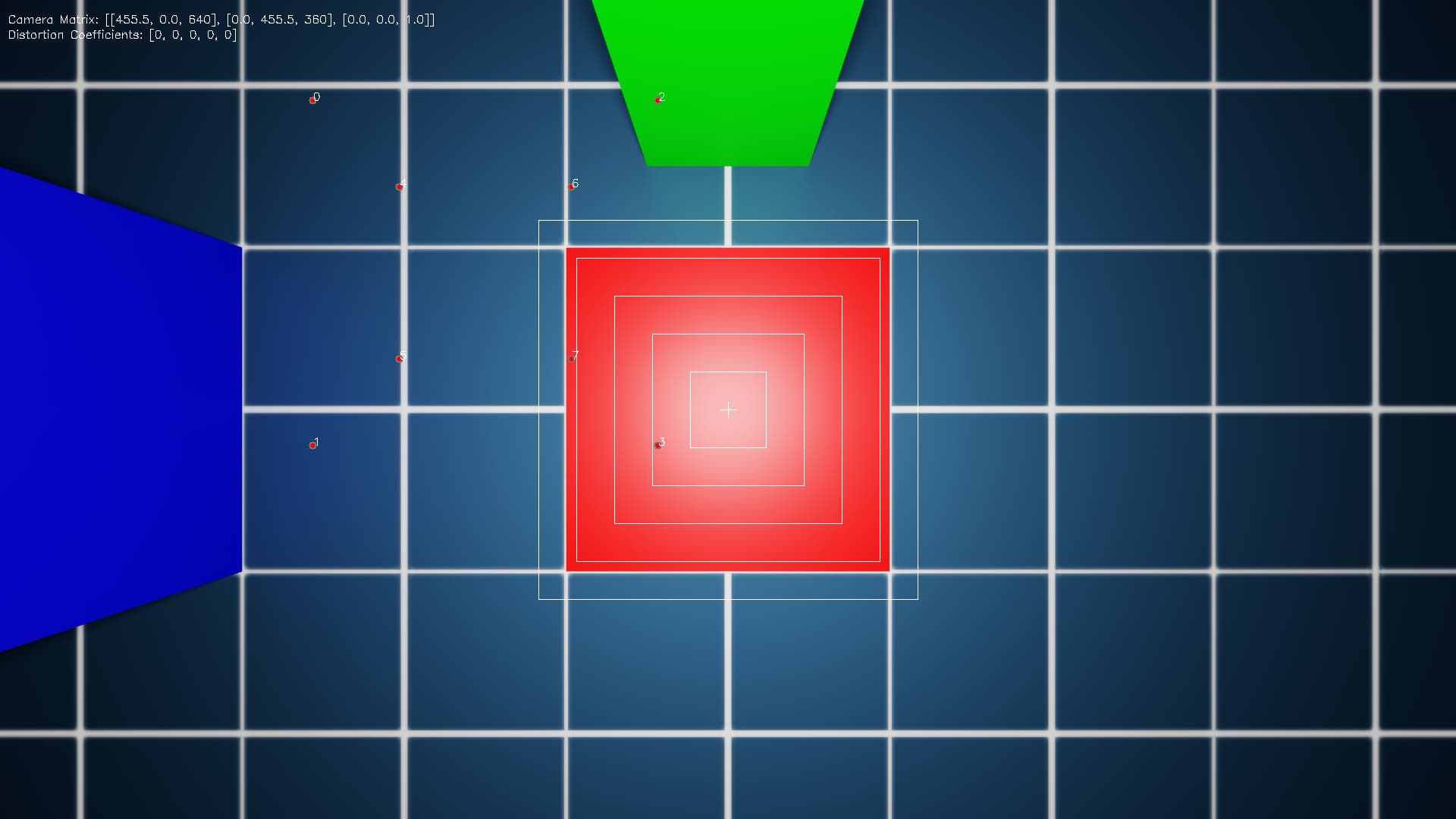

If Isaac’s rendering was matching opencv, the dots on the image would line up with the corners of each cube:
fisheye:
pinhole:
I’m working on a use case where it’s important that the camera intrinsics model matches exactly with opencv, so the discrepancy here makes Isaac Sim unusable. Are the opencv-based rendering models supposed to match up exactly? Am I doing anything wrong in my snippet to reproduce this issue?
Hi, @ericpedley thank you for your question. I will see if I can reproduce and get back to you
I think the problem might be related to the fact that opencv has two distortion models built in, one in cv2 and one in cv2.fisheye. Using cv2.fisheye might solve all my problems, I’ll check in the next few days when I get a chance to work on this again.
Nope! Still looks very off.
Okay I think there is a chance that isaac is just working in a very unintuitive way here and is not actually completely broken. It seems like the render product dimensions are only scaling the image, instead of setting the width of the image. I’m not sure how to better put this into words, but these examples are illustrative. The first example is rendered at 720p, and both the opencv reprojections and isaac sim image of the red cube are centered in the image. In the second example here, I keep the parameters the same, including the principal point, but set the size to 1080p, and the image looks the exact same, even though the principal point should be way off the center of the image, and the FOV should be different because the focal length in pixels has stayed the same while the width changed.
Okay, after experimenting more, I’m certain that Isaac is bugged. I set the principal point to (10,10) in the camera matrix and the image looks the same. The only parameter that seems to affect anything is fx. It completely ignores the width, height, cx, and fy.
I’ve figured out the behavior of isaac: all the basic camera parameters except fx are stuck at their defaults, except for fy, which is actually equal to fx, instead of its stated default of 800. The distortion coefficients are not ignored but the model seems to not line up with opencv’s projections. The defaults are listed here: Cameras — Omniverse Materials and Rendering
Here is a test image where the reprojections finally line up.
Here’s an example with distortion where things don’t line up.
Even if the property setting was working correctly, I think this would still be broken because the camera class never sets the imageSize property. I patched it here (patch camera to temporarily print debug info and set imageSize for th… · EricPedley/IsaacSim@c71f036 · GitHub) but it seems like the params are still stuck at their defaults. Based on this I’d guess that it’s a bug with Omniverse, not Isaac Sim, since it seems to be setting the properties exactly how they’re documented.
While looking through the isaac source code I found an even more comprehensive example of rendering at IsaacSim/source/standalone_examples/api/isaacsim.sensors.camera/camera_opencv_pinhole.py and it also proves my point that the reprojections don’t line up.
At this point I’m pretty confident the bug is somewhere in the proprietary omniverse code. I think my strategy going forward with this will be working around the bugs by rendering only with settings that line up with the opencv model, then applying distortion effects and perspective warps as a postprocess step to make up for the fact I can’t control the principal point or get distortion that lines up with opencv’s model.

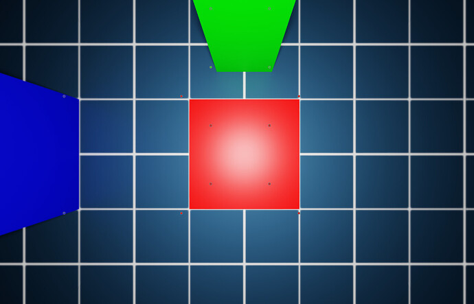

Hi @ericpedley! Thanks for your detailed analysis, and apologies for a delayed response. I wanted to update you re. the issues you raised.
As you observed in the patch you shared, the imageSize attribute isn’t being set by the isaacsim.sensors.camera.Camera.set_opencv_*_properties methods. I’ve incorporated that into a fix for Isaac Sim 5.1.
A temporary fix for any users who may find this thread later is to directly set the attribute if they’re using OpenCV schemas:
from isaacsim.sensors.camera import Camera
from pxr import Gf
resolution = (1920, 1200) # example resolution
camera = Camera("/World/camera", resolution=resolution)
camera.initialize()
camera.set_opencv_pinhole_properties(...)
# Manually specify imageSize using camera resolution
camera.prim.GetAttribute("omni:lensdistortion:opencvPinhole:imageSize").Set(Gf.Vec2i(resolution[0], resolution[1]))
In examining the issue we also found a bug where specifying OpenCV schema attributes via the UI doesn’t take effect on the actual prim, while specifying the attributes directly via USD APIs (like what isaacsim.sensors.camera.Camera is doing) works as expected. We’re working on a fix for that too.
Re. your observation on property settings - when I patch the imageSize issue and use the same camera matrix and distortion coefficients you provided in the second image here, I get the following:
Where the cube corners are aligned as expected. The critical note is I’m setting imageSize to be the same as render product resolution.
(Edit: I’m realizing the image was slightly compressed upon upload - but the original was a 1920x1200p image with the corner points correctly aligned)
