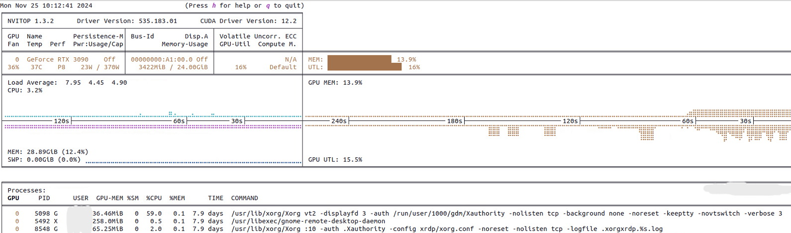

Fig. 8 nvitop screen with some remote desktop processes. The picture shows 59.0% CPU for the first PID and appears that 100% is the maximum value, but I often see Isaac Sim app go over 200% CPU

The poor CPU threads utilization was very likely the cause of using Gnome for xrdp remote desktop connection.
After uninstalling Gnome and configuring xfce4 for xrdp, Isaac runs very smoothly and responsive.
