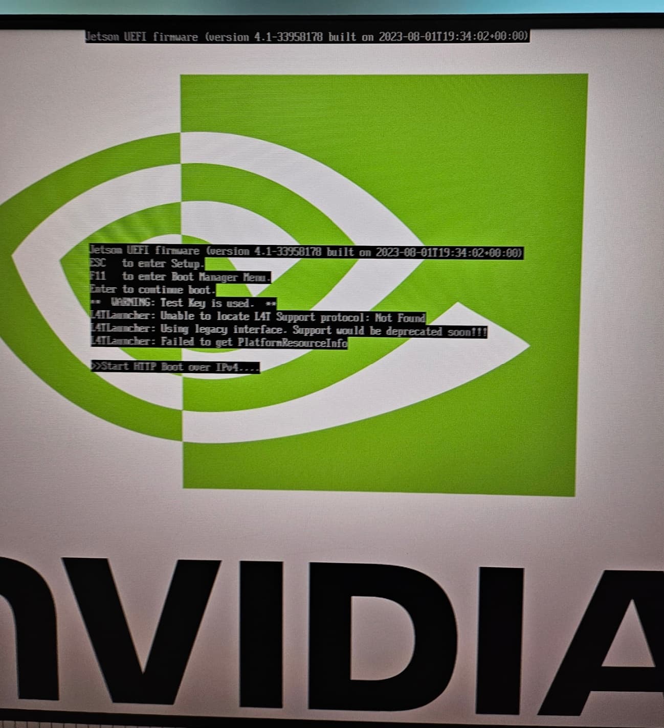

I am working with a Jetson Orin NX 16GB module along with a carrier board, and I’m trying to flash JetPack 5.1.2 onto the board.
Previously, the Orin NX was flashed with ‘JetPack 6.2’, and everything worked fine. However, after flashing JetPack 5.1.2 today, the system stops at the NVIDIA logo screen and shows the following messages:
L4TLauncher: Unable to locate L4T Support protocol: Not Found
L4TLauncher: Using legacy interface. Support would be deprecated soon!!!
L4TLauncher: Failed to get PlatformResourceInfo
This BSP used to work without any issues, and I haven’t changed anything since. But now, flashing 5.1.2 results in this error.

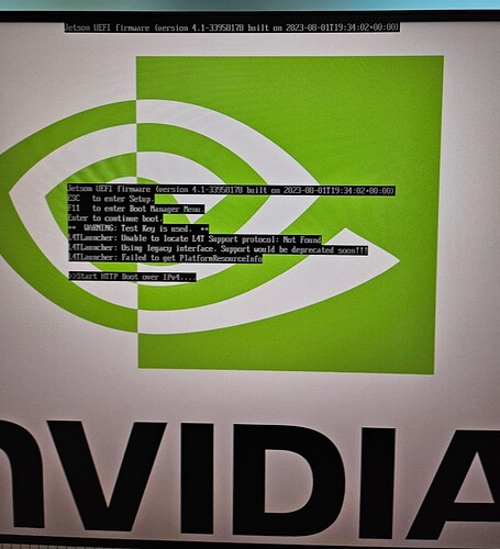

However, during boot (at the NVIDIA logo screen), the following messages appear:

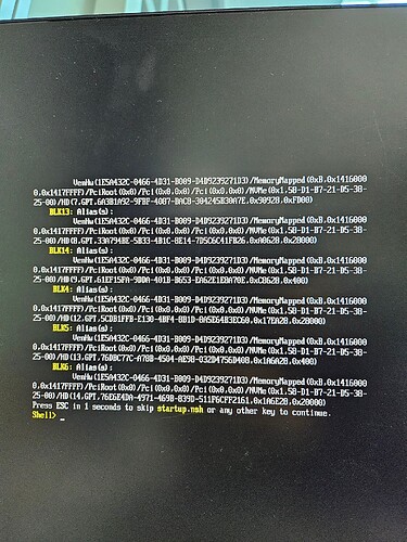

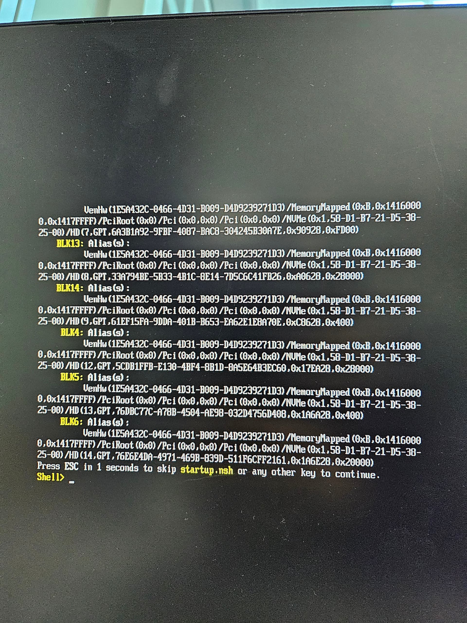

A few seconds after this, the system drops into a shell.
I can’t exit the shell, and I’m not sure how to proceed from here.
Since I’m unable to copy the logs directly, I’ve attached a photo showing the messages.
Thank you for your support.

Did you ever change the content of BOOTAA64.efi before? This is for the L4TLauncer.
I haven’t changed the BOOTAA64.efi file. It’s still the original version.

Please be aware that “changing a UEFI version” is a obvious thing from UART log.
Jetson UEFI firmware (version 4.1-33958178 built on 2023-08-01T19:34:02+00:00)
There is no Jetpack6.2 on 2023 08/01 at all. This means UEFI version is already going back to Jetpack5.
