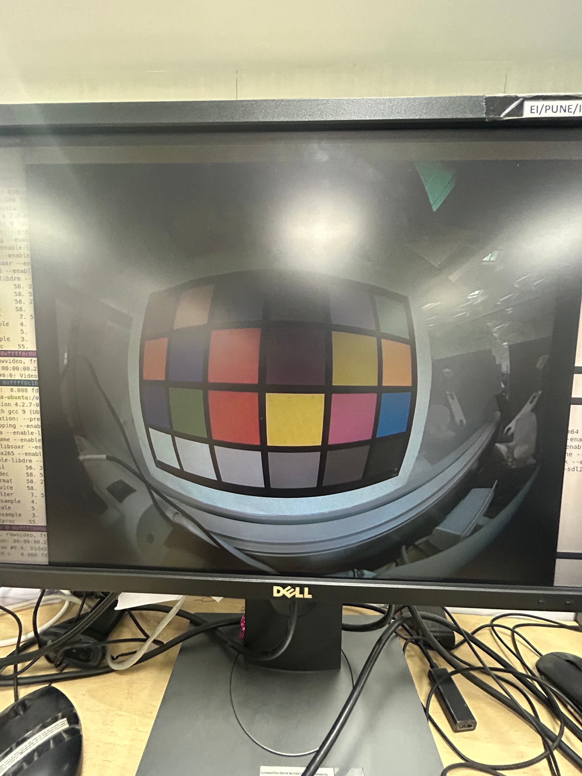

Hi team, I am trying to execute image ldc sample. But I am running into some issues and I want your help in this. The sample takes yuv file which is distorted and it makes this file undistorted after execution of this sample, right?
I opened one of the yuv files named “fisheye_1280_1080_yuv420. yuv”, by using “ffplay -f rawvideo -pixel_format yuv420p -video_size 1280x1080 fisheye_1280_1080_yuv420. yuv”
This is what I could see this yuv file (I could only see image, not video) attached below
Please help!

This is what I could see after executing img ldc sample, is something wrong here?
nvidia@tegra-ubuntu:/opt/nvidia/drive-linux/samples/nvmedia/img_ldc$ ./nvmimg_ldc -cf ldc_basic.conf -v 3

nvmedia: Processing frame:0
nvmedia: ERROR: Can not open file
nvmedia: ERROR: ReadYUV failed! status = 7

May I know the used DRIVE OS version ? I don’t see input files in sdk.
Also, did you check How to run nvmimg_ldc sample app - #4 by SivaRamaKrishnaNV ?
Dear @SivaRamaKrishnaNV
It’s DRIVE OS 6.0.8.1.
This yuv file is present at /drive/drive-linux/samples/Media/fisheye_1280_1080_yuv420.yuv
Dear @akshay.tupkar ,
I opened the same file in 7YUV and noticed 5 frame when scrolling down. Does that help to clarify ?
I executed the sample and it generated a “out_fisheye_1280x800_yuv420.yuv” file but I am not able to view it.
After executing the sample, I could see this out_fisheye_1280x800_yuv420.yuv file. Should I consider it as a undistorted?
The image looks not correct. Could you share the used config and steps?
I have used ldc_basic.conf file and used command is “./nvmimg_ldc -cf ldc_basic.conf -v 3”
Dear @akshay.tupkar,
Could you check private message? I shared input video file and command used to test.
