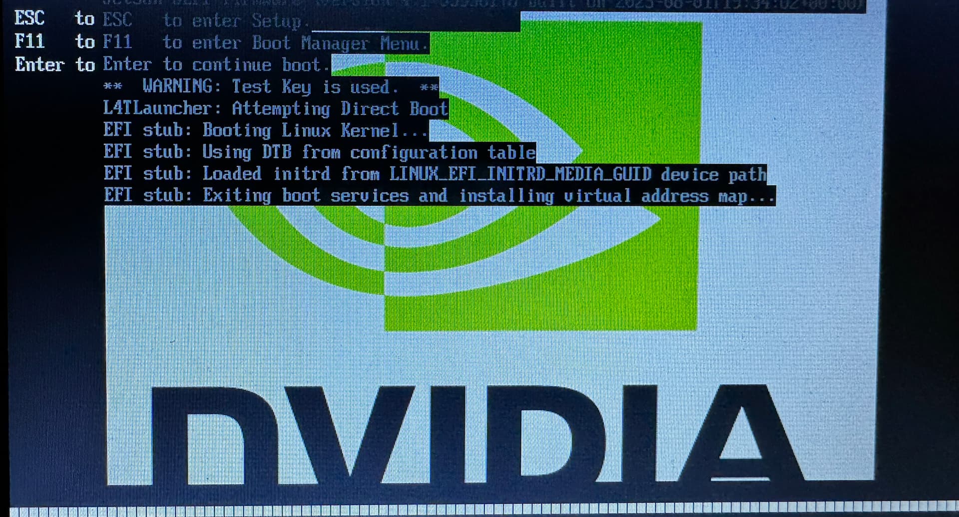

I was trying to upgrade JetPack on a new Orin. Now, when the unit tries to boot, the following is on the screen only.
I have tried all sorts of ways to reset.
I have to confess to being a bit lost with what best to do next. I am running Linux virtual machine on Mac, but there is no package to install SDK Manager by the looks of things. Ideally I guess I’d re image, but how do I do that now?
Any help gratefully received.
Please find a real Ubuntu 18.04/20.04 PC for re-flashing.
We don’t officially supports VMes as they are unstable in terms of USB connection.
