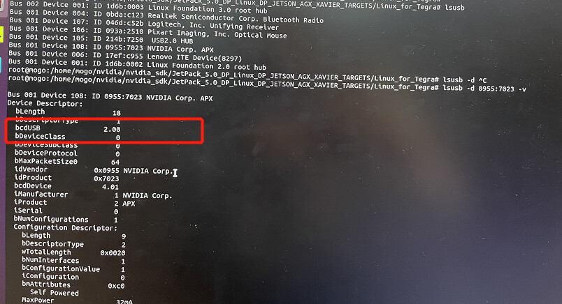

Jetson AGX Orin Dev kit reflash can't transition to USB3.2
hi
we test the Jetson AGX Orin Dev kit reflash,it just USB2.0,can’t transition to USB3.2.
Are you sure the usb port on your host side supports USB3.2?
YES, I use the same USB port to test other USB device, it’s speed can up to USB3.2 .
So ​If I need to change software to control Jetson AGX Orin reflash transition to USB3.2 ?
We’re working with internal team to fix this problem. Thanks
What’s the update since 4 weeks passed away?
This requires some hardware work and we are still checking how to let you enable that.
