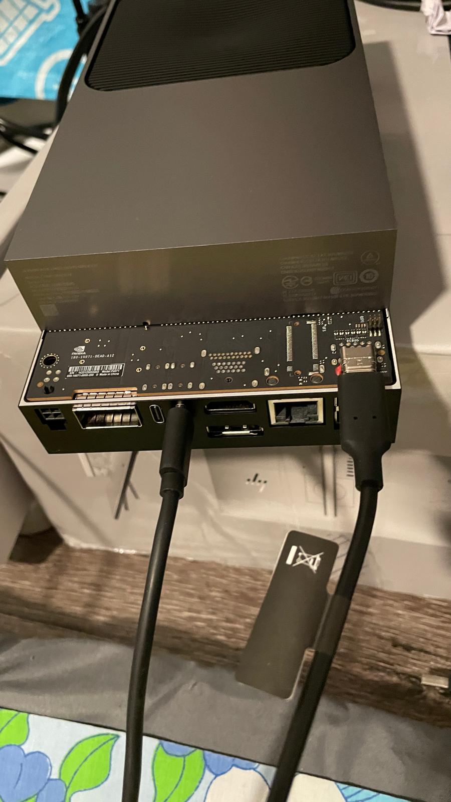

Could you take a picture of how your cable got connected to the board?
@WayneWWW Thank you for your prompt reply. I am attaching pictures below.
This is when I am trying to boot or in general I connected. Power Cable, Display Cable, LAN, Keyboard and Pendrive, I have connected.
When I am connecting to my laptop to flash through SDK manager, I have just the power cable and USB C to my laptop.
Kindly help me resolve this issue.
Farhana
I think the bottom picture shows the error. You are connected to the debug port.
Instead plug the nvidia usbc cable into the usbc port next to the usbcPower connection on the Thor.
Plug other end in to your laptop. Then while holding the middle button, hit the power button, then release both. Then use sdkmanager to flash you Thor.

After all the struggle, I was able to flash jetson using the SDK manager. But the SDK manager was able to flash only os image file and I had to manully install the SDK components.
