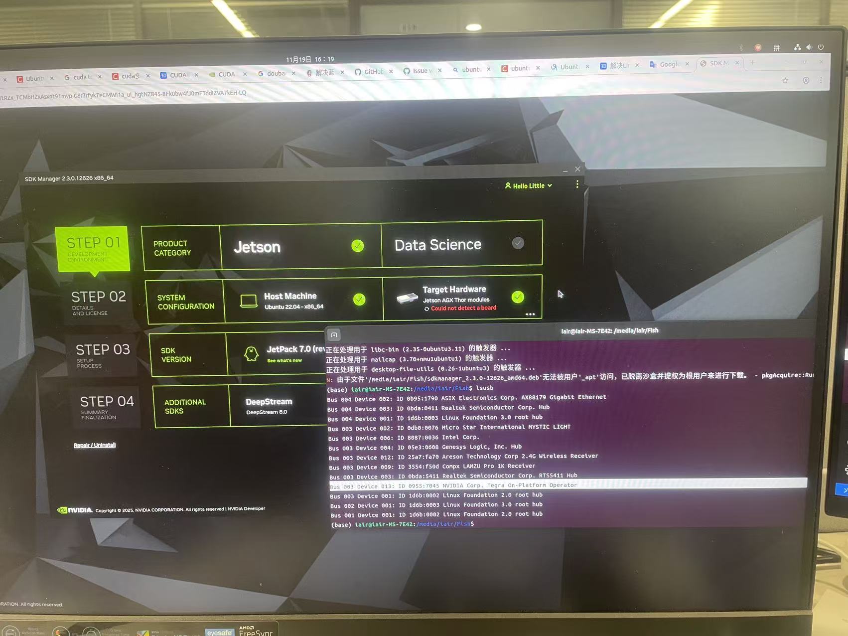

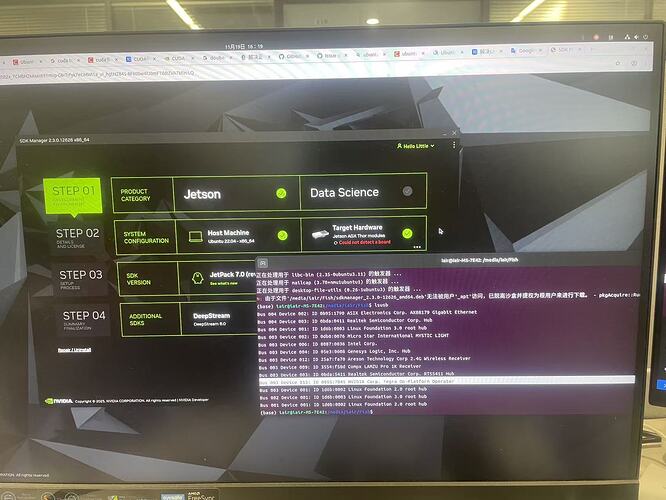

I am attempting to use the SDK manager to complete the flashing process, but I am currently facing an issue where the board is not being detected. I have followed the manual instructions to enter recovery mode, but it has not been effective.
Please ensure that the host system is running on a native Ubuntu installation rather than a virtual machine, as there is a detection issue when using a virtual environment.
Hi, I find a native ubuntu22.04, and followd the steps of offical doc,
It seems that the power button is malfunctioning. When the power cable is connected, long-pressing the power button cannot turn off the device. I disconnected the power cable, then long-pressed the recovery button, held down the power button, reconnected the power cable, and then released the power and recovery buttons, but I still cannot enter Recovery Mode.

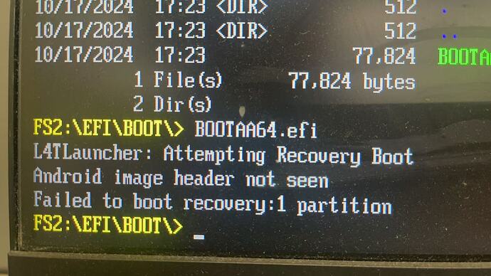

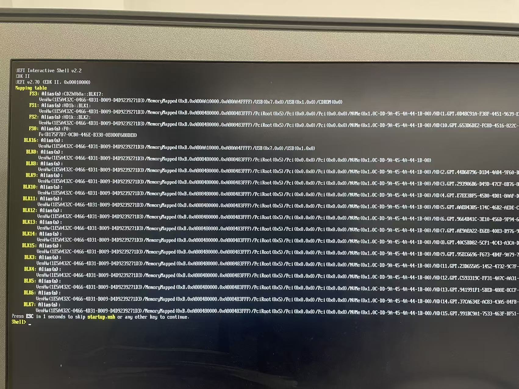

I have follow this log Re-enable USB stick installation, start a new installation.
but when I execute this step finised
and then start a UEFI Shell
not start the UEFI firmware update process like this
Please refer to the Jetson AGX Thor Developer Kit Carrier Board Specification
to host port only for debug purposepower port for recovery mode port purposePlease move your to host cable to J81 port and power cable to J82 port
