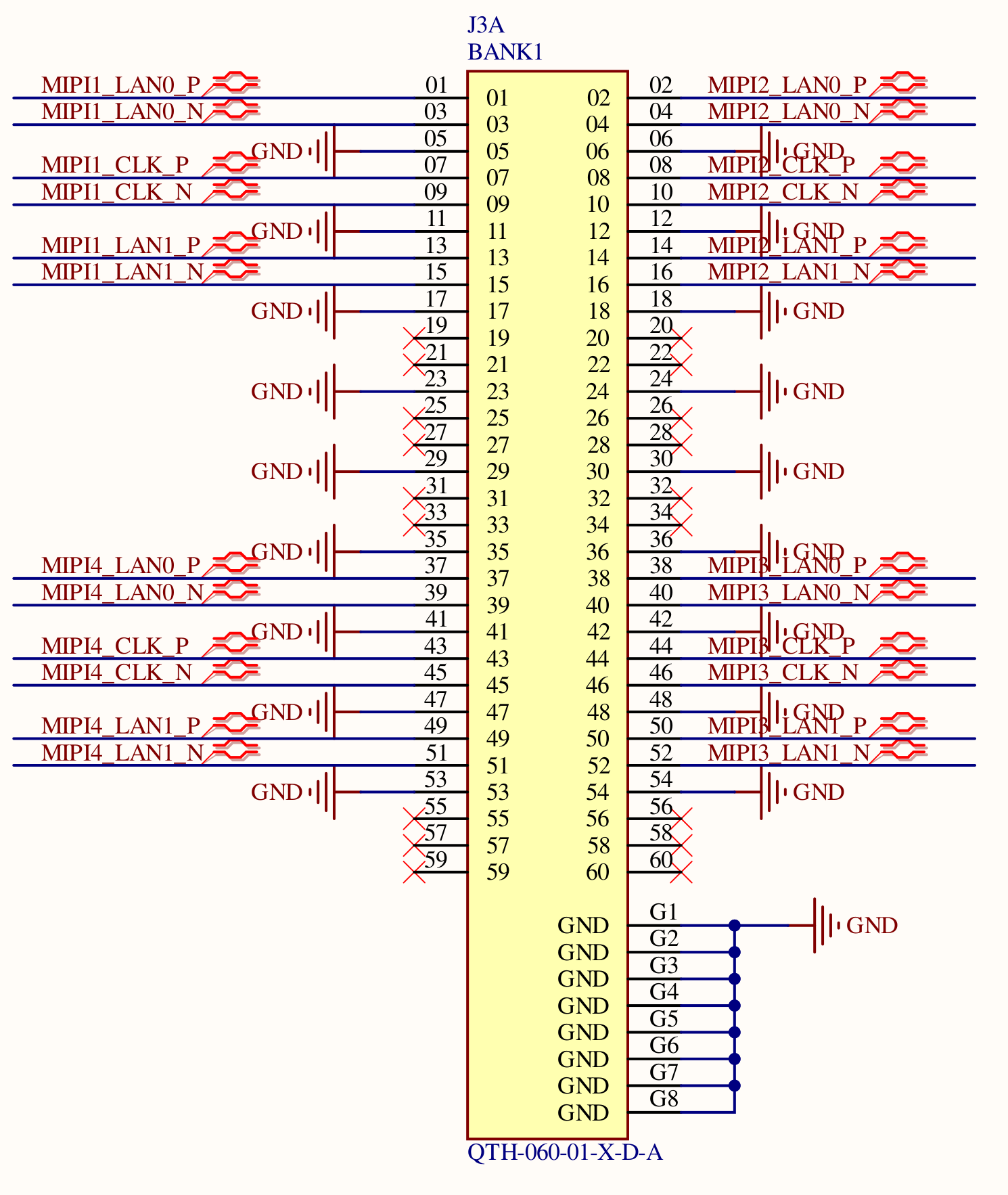

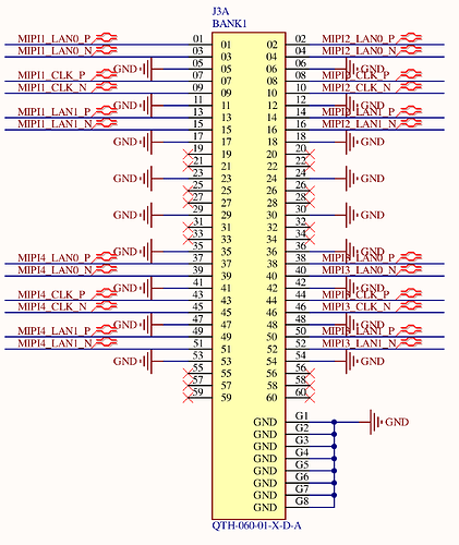

Hi there!
I’m trying to use 4 RAW camera (or 4 - 2x CSI lanes) data input from FPGA to Jetson AGX Xavier.
I’ve used Jetson AGX Xavier MIPI CSI-2 without I2C from FPGA this topic to create my own non-I2C driver on L4T35.4.1. But there are some things that I didn’t understand.
In the Camera Development page on Wiki page, it is mentioned there are multiple CSI port index that I can select. But, I didn’t understand how to assign to device tree file. My design has 4 CSI line that configured as 2x bus width.

Can you help me to configure the CSI lines? I want to use a single line for data in, a single line for data out for each camera.
Here is my camera configuration:
What are those 4 cameras connect to?
Hi!
I mentioned it wrong, sorry. I’m trying to simulate 4 camera array from FPGA. FPGA is gonna generate MIPI CSI-2 x2 data. The problem is, I can’t undrerstand how to define ports and lanes in the device tree. There is a schematic of my MIPI CSI-2 connector on the topic.
Thanks for your reply.
Can tell how the camera connect to which CSI from the schematic.
Below is the configure.
        port-index of CSI                port-index of VI
CSI-A      0                                      0
CSI-B      1                                      1
CSI-C      2                                      2
CSI-D      3                                      3
CSI-E      4                                      4
CSI-G      6                                      5
Thanks for your answer.
I have another question. Should I seperate CSI lines for VI and OUT? Like;
CSI-A      1                                     0
CSI-B      3                                     2
CSI-C      6                                     4
CSI-D      ???                                  5
Doesn’t looks like right for it.
Actually, we don’t need a CSI output. We are simply sending data from FPGA to Xavier AGX. So, it means we can modify the tree like this, right?

Looks like your understand is incorrect.
The CSI/VI is bounding the port-index is like I said.
CSI output means output to VI like
FPGA → CSI → VI → MEM

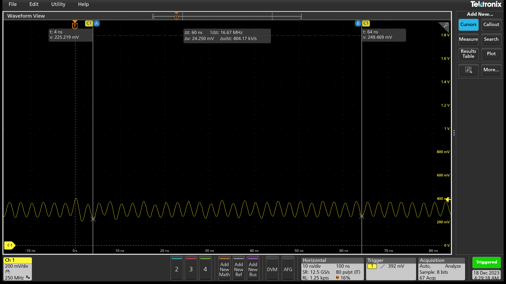

And here is the waveform outputs:
The trace log still shows no thing.
Maybe confirm the device tree configure match the HW connection.
Hi! Here is my device tree configuration:
