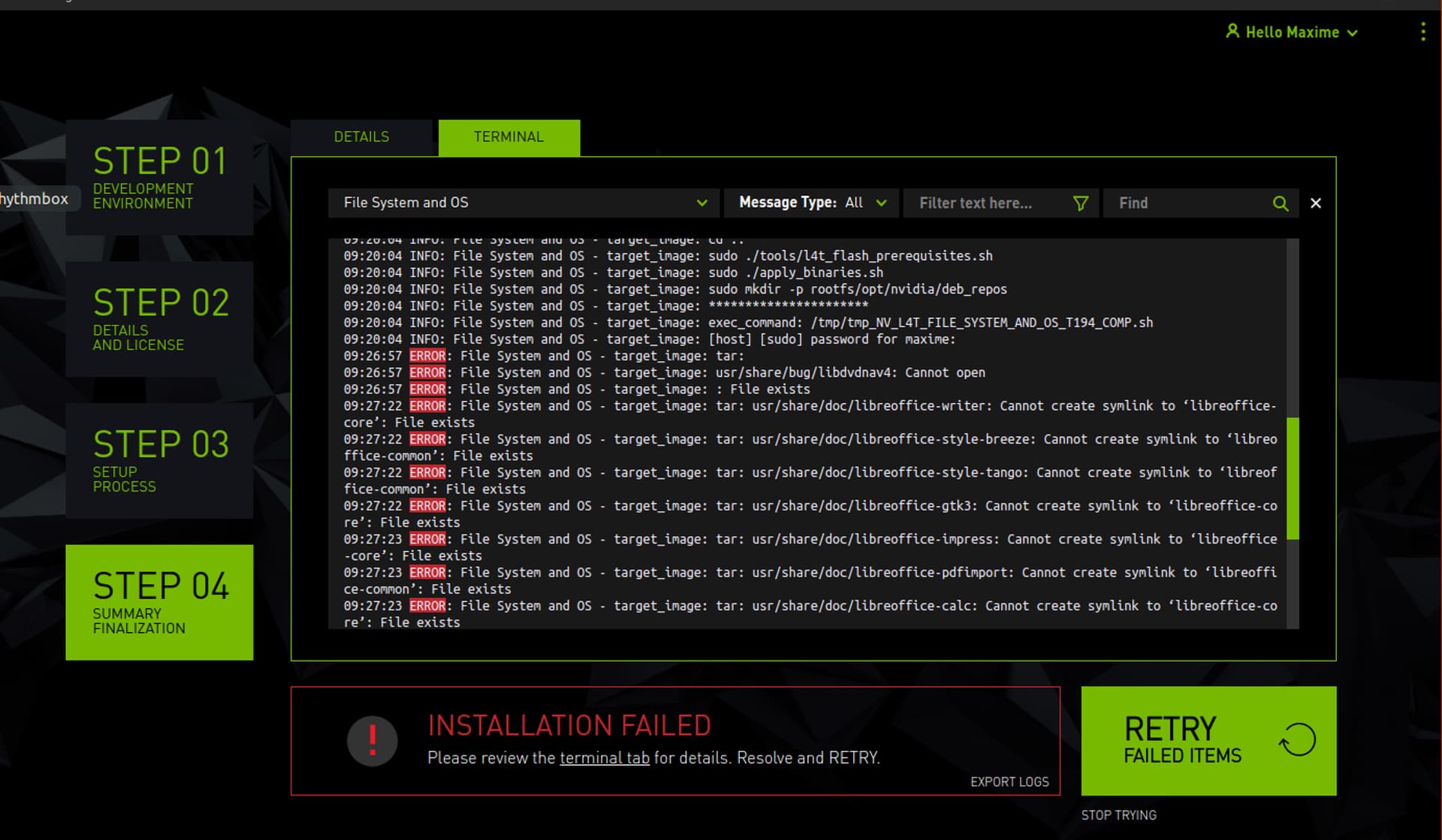

I bought a second-hand Jetson AGX Xavier and I try to flash it. The process stop at the installation of Jetson OS image in Target Components.
I’ve try with
  • host pc 1 : VM Ubuntu 18.04
  • host pc 2 : Ubuntu 20.04.4 without VM
How I proceed :
I connect Xavier module to the pc, turn it in recovery mode then the host pc detect correctly the Xavier module with SDK Manager. I follow the steps 1, 2, 3, 4 and the installation stop at step Jetson OS image/File System and OS.
I’ve try the different version of JetPack :
  • 4.6.1, 4.6.2 with Ubuntu 18.04 on host pc
  • 5.0.1 DP with Ubuntu 20.04.4 on host pc
    The installation always stop at the same point
Could someone tell me what’s the problem ?
Thank you
Here it’s the log :
SDKM_logs_JetPack_4.6.1_Linux_for_Jetson_AGX_Xavier_modules_2022-05-31_09-19-08.zip (107.0 KB)
And some screens shot:

VM ubuntu is not stable to flash the board. Better try to use the native host.
Also, the flash process is not even starting. The process even got failure when preparing the file on your host.
Suggest to use 4.6.1, 4.6.2 with Ubuntu 18.04, and and 5.0.1 DP with Ubuntu 20.04. both should work native Ubuntu host PC, not VM.
Thank you everyone for your time.
It works now, I’ve flash successfuly the Jetson Development kit.
I’m not sure about the reason but I’ve erase precedents installed versions and I’ve also connected ethernet cable to the Jetson kit.
