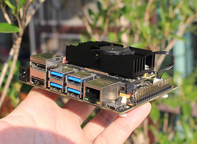

maybe one of these
There are some companies developing processor modules with Rockchip chips and Jetson Nano/NX compatible pinout and form factor. Compatibliity should go both ways, and maybe their carrier boards are more affordable.
