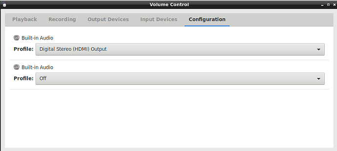

Hi, if you are on the Jetson Nano 2GB Developer Kit and can’t get sound on your monitor, try this:
Check your session
echo $DESKTOP_SESSION
If you are using LXDE (which comes preinstalled), I recommend you download pavucontrol to change your output source.
sudo apt-get install pulseaudio pavucontrol
Then use the Configuration tab to change your Built-in Audio settings to use your HDMI output, and turn the other option OFF
With HDMI:
On 2GB, assuming you didn’t choose minimal option for OS installation, go to:
Sound & Video>PulseAudio Volume Control> Configuration Tab>
Built-in Audio: Profile Digital Stereo (HDMI) Output (Leave this as it is)
Change the second profile to “off” (default is on Analog)
hdmi works on my tx2, but quits working if I use pavcontrol to enable anything in the Built-in Audio, hdmi sound works if Built-in Audio is profile “Off”
