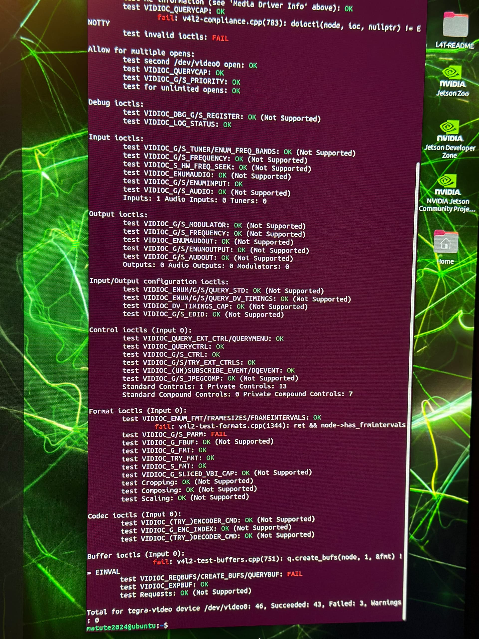

I tried this, but got the following:
Compliance with v4l2 1.22.1, 64-bit, 64-bit time_t
Cannot open device /dev/video0, exiting.
for both, video 0 and 1.
The driver seems to be missing although I followed the configuration through the Jetson-io guide
Check the driver been loaded correctly.
sudo dmesg | grep -i imx477
I tried and I got following message from terminal
with sudo dmesg | grep -I imx477:
probe of 9-001a failed with error -121
should I remove R8 resistor as mentioned here?
Suppose yes.
It was not necessary, thanks for your sopport, it’s working fine now
