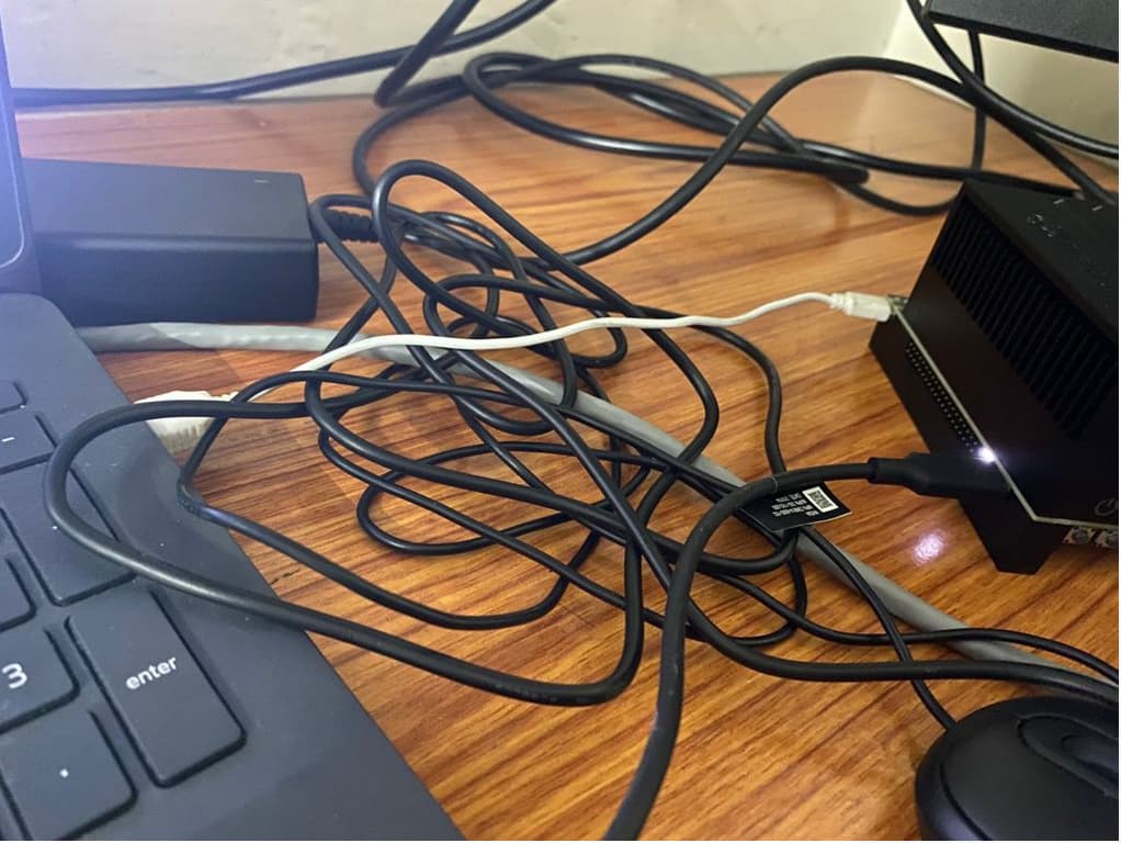

how to check the log from micro usb?
After you connect it to your host, you shall see ttyUSB3 on your host… then it is back to the serial console post I shared in the beginning…
this is my connection, even after connecting to microUSB when I try “ls -l /dev/ttyUSB*” it says “ls: cannot access ‘/dev/ttyUSB*’: No such file or directory”
Are you sure your mirco usb cable isn’t just a charging cable?
Yes i have replaced the cable, i can see ttyUSB3 but still no logs
