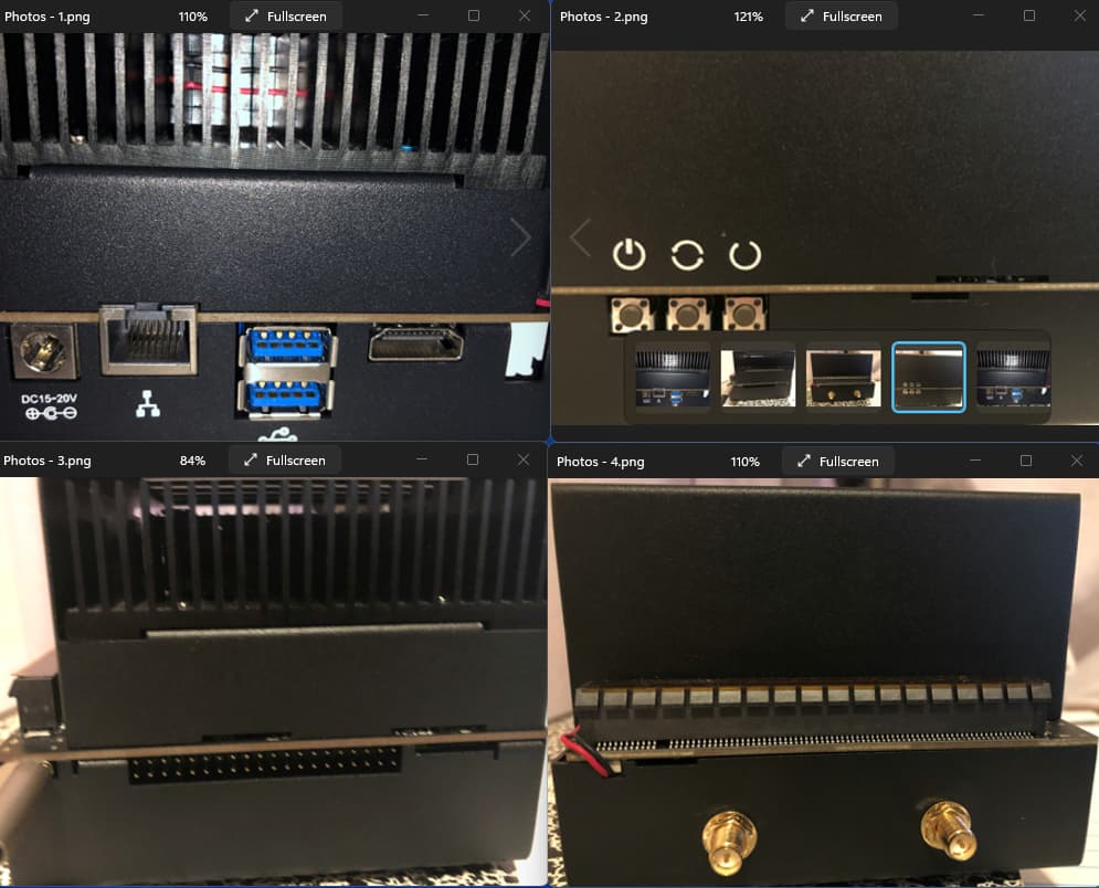

Here are the views of my kit, Rx/Tx are in the Expansion Header ? Do you mean that I need to open the box to find them and find a way to connect to my Ubuntu host ? Please advise in a bit more details, thanks.
If your board is not nvidia developer kit, please contact your board vendor to check how to dump uart log.
Or even how to flash the board.
If you are still not able to understand what I am trying to say, some more explanation.
  1. Your board is not NV developer kit, this is custom board from other board vendor. They use AGX Xavier module as core and the I/O board (carrier board) is made by them.
  2. Not every carrier board is able to be supported by sdkmanager. Ask the board vendor if they have their own BSP package to flash their carrier board.
I bought it from Amazon with a quite high price, how to identify whether or not it is from NV or other board vendor ?
You can refer to the document for AGX Xavier developer kit. This document lists out what our carrier board should be like. For example, we don’t have two type A usb ports on it.
