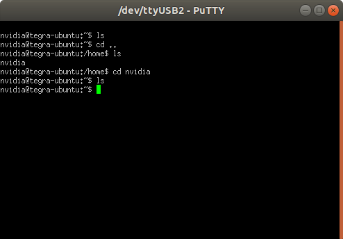

I seem to be missing: /home/nvidia/drive-t186ref-linux on target but I do have it on my host machine.

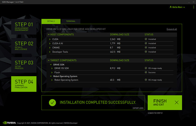

I re-flashed with DRIVE OS 5.2.0 with the same result. Should /home/nvidia/drive-t186ref-linux be on the target after this step? Or after installing Driveworks?
Screenshot from 2021-02-09 10-38-15
Please share the file referenced by ~/.nvsdkm/sdkm.log. We would like to check the log of your installation. Thanks.

Is there any file/directory under below path on your host system? Have you select OpenDDS in “Additional SDKs” during installation?
~/nvidia/nvidia_sdk/DRIVE_OS_5.2.0_SDK_Linux_OS_DDPX/DRIVEOS/drive-t186ref-linux/targetfs/home/nvidia/drive-t186ref-linux
~/nvidia/nvidia_sdk/DRIVE_OS_5.2.0_SDK_Linux_OS_DDPX/DRIVEOS/drive-t186ref-linux/targetfs/home/nvidia/ is empty. No I did not select OpenDDS during installation… Should I?
Then it is expected. Only OpenDDS selected, some samples will be included in the path.
BTW, those samples mentioned in NvMedia Sample Applications are available in ~/nvidia/nvidia_sdk/DRIVE_OS_5.2.0_SDK_Linux_OS_DDPX/DRIVEOS/drive-t186ref-linux/samples on host system and you can follow Building and Running the NvMedia Samples to cross compile them.
Not installing OpenDDS was my issue, thank you.
