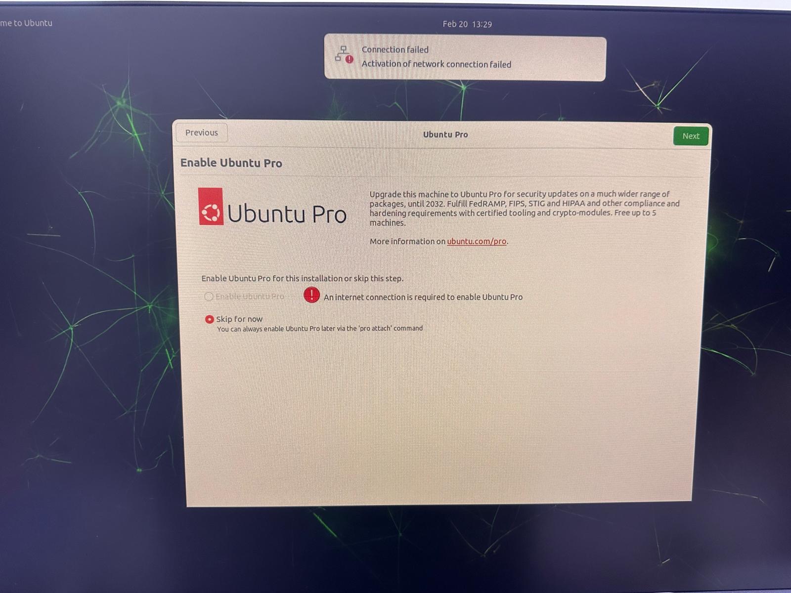

Keyboard is working when i connect it. But mouse is not. So I could not click “Next” bottom
When I am flashing OS using SDK manager in ubuntu 22.04. I have faced “Could not detect a board”, i thought that OS already flashed and okay to use.

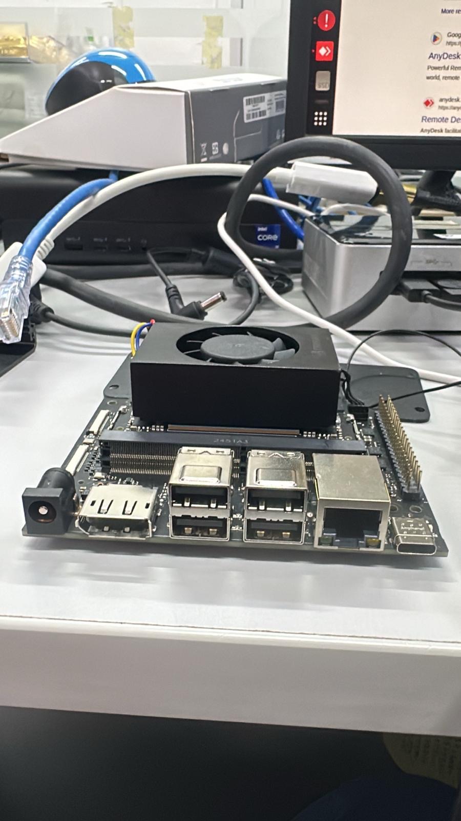

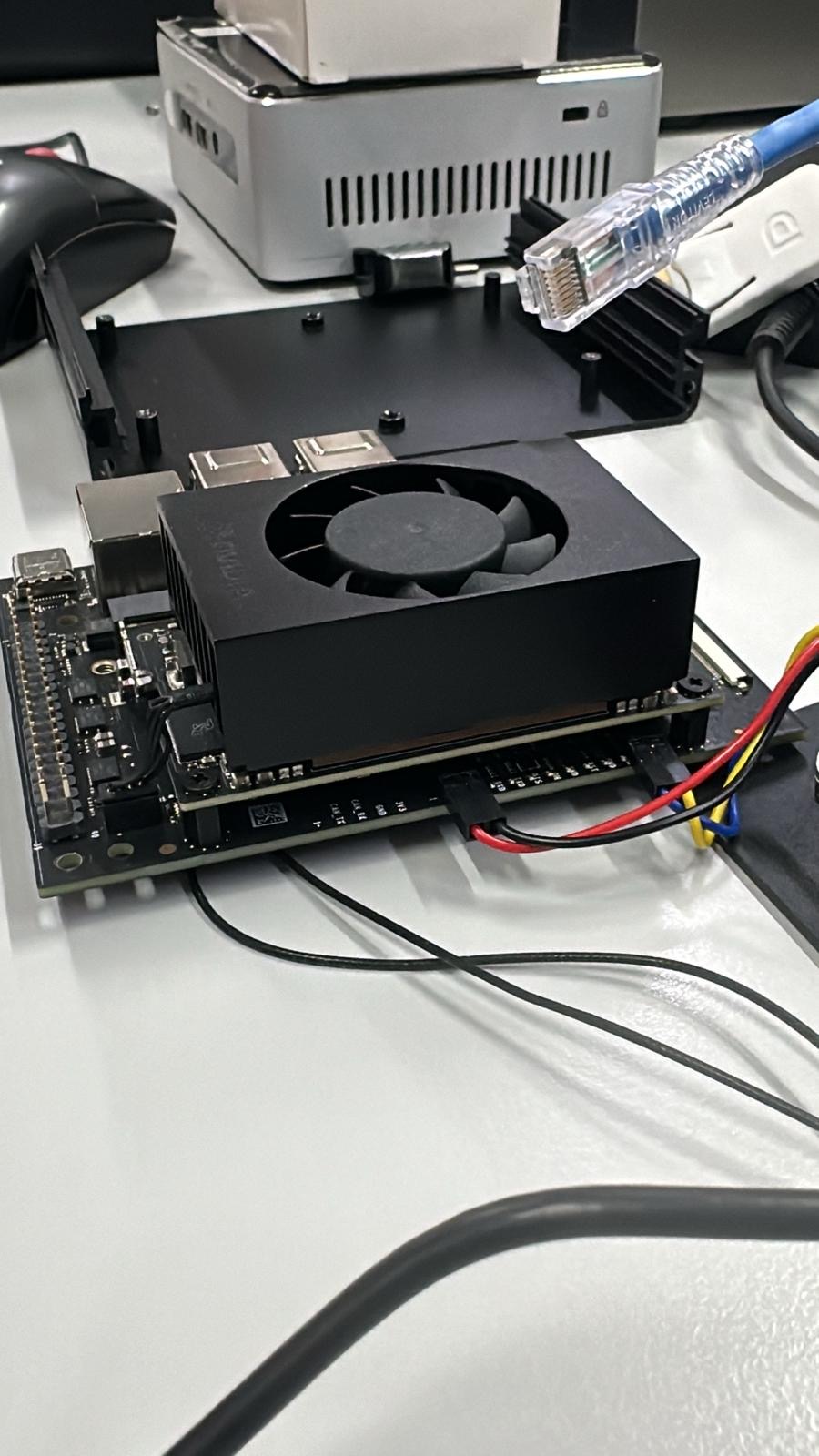

My board layout.

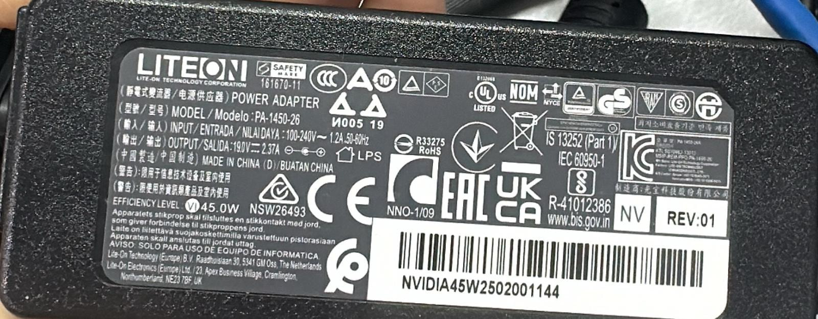

and this is my power supply

I saw the fusb301 controller on your board is gone.
[ 12.026944] fusb301 1-0025: fusb301 not support
[ 12.026949] fusb301: probe of 1-0025 failed with error -22
If this is truly NV devkit, then some hardware might be broken there.
