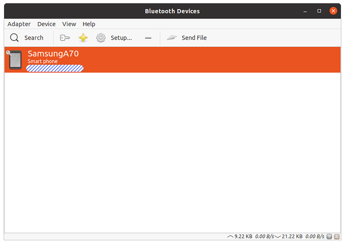

Hi when I try to pair MX Keys Mini, Bluetooth keyboard of Logitech to Orin Nano 8G via BlueMan it hangs for a minute then restarts. Though the keyboard was paired happily to Raspberry Pi 4, Jetson Nano 4G (+Intel WiFi module) and to my Samsung smartphone.
For information, do you use RTL8822CE or the intel module connecting to Key-E on Orin Nano developer kit? And it would be great if you can upgrade to Jetpack 5.1.2 and try.

Updated JetPack to 5.1.2 and still encounter the crash. Only refreshed apt packages and installed blueman manager. Modified the title to new version.
Does the device require additional driver? Jetpack 5 is with Kernel 5.10. Probably certain configs have to be enabled for the device. You may try other bluetooth device, to clarify whether the failure is specific to the device.
On legacy Jetson Nano 4G it works without any additional drivers, but I’ll try to pair a Bluetooth handheld device.
Managed to pair my smartphone,
but these two devices - mouse and keyboard still crash entire JetPack 5.1.2
