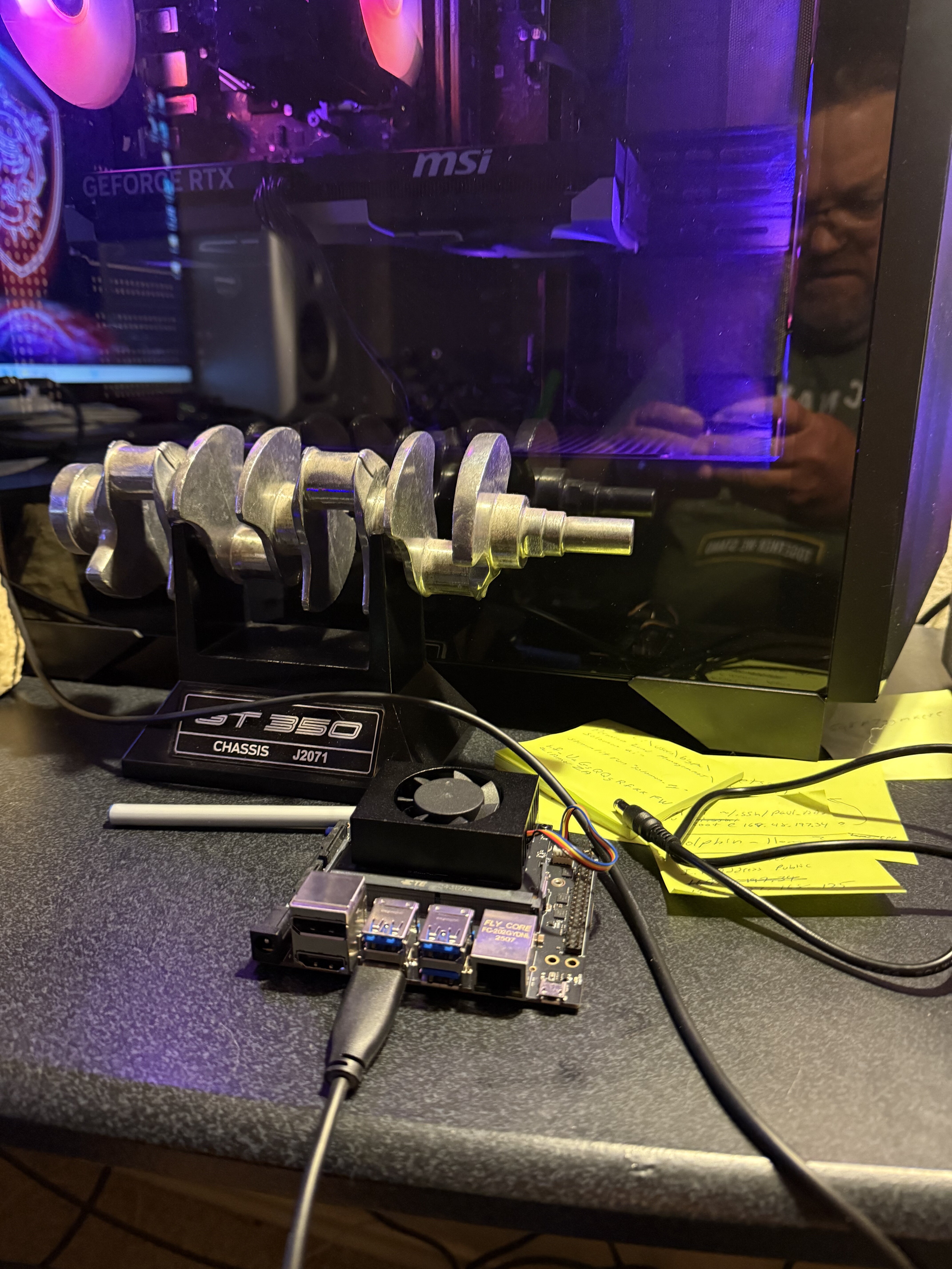

Nothing. With the jumpers in place I applied power and saw a blue light. Then disconnected the ground. Tried to pair to it in the SDK manager and it still does not see it.
Please take a photo for how are your jumper, power cable and usb cable connected.
Also confirm which USB connector you are using in flash and whether there is a HUB between the Jetson and host PC or not.

I tried the correct pins from the diagram you sent me. That didn’t help. I am attaching the usb pic as promised.

What is your USB connection there? We need your whole picture when you try to connect your Jetson to host PC and also also the recovery pin.
You could put the recovery pin during the whole flash process. No need to remove jumper.
The usb is connected to this tower. I tried to show the jumper and carrier board as well.
You didn’t connect your flash USB port to anything out.
Is this truly what you did when flashing the board?
Flash port is J28. Only this micro USB port could be used to flash the board.
What do you mean? I flashed the card, multiple times then inserted the card. When that didn’t work I downloaded the sdk manager and connected the usb as instructed. It doesn’t read my board. So what do you mean is that what I really did?
How did you connect your Jetson to your host PC?
Your photo shows that you didn’t connect it with a valid usb port.
What “instruction” did you follow there when using sdkmanager?
Just to clarify. Please forget about sdcard. Sdcard image won’t really reflash your board.
You need to use sdkmanager to flash your board. But I don’t know if you really connect your host to your Jetson correctly. From your photo, I saw you didn’t connect anything to the flash port.
