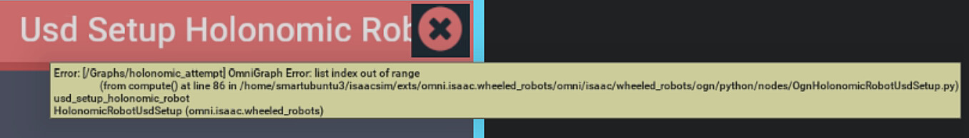

I’m trying to implement holonomic control on Omnigraphs for a 4 wheeled mecanum robot I’m using for research. I added the isaacmecanumwheel:angle and isaacmecanumwheel:radius attributes at -135 and .055 respectively on each wheel, which I did because I was following the troubleshooting info provided in this forum post "USD Setup Holonomic Robot" node not working for holonomic robot. Now i get a “list index out of range” error at line 86 of the OgnHolonomicRobotUsdSetup.py file, which appeared to be an expected error response from the catch statement at that line. I dont know why the error is happening though, and my best guess is that maybe something is wrong with my model or mesh or some prim path issue. The node is pointing towards the base link of the robot for comPrim, and the robot for the robotPrim. Any help on this matter would be greatly appreciated, thank you kindly.

I tried using print statements in the .py file to see where it might be freaking out, but none of them outputted anything. I’m not sure where its supposed to be outputting if I did print something, I’m guessing console?

@zhengwang ok so I’ve done some digging, and I think the issue is with how my links are set up in Isaacsim. I looked at the class that was being referenced by the node, and put some debugging print statements in there. It keeps spitting out that /turtlebot3_waffle/wheel_left_link has no targets. This is strange to me, as the wheel_right_joint DOES have valid prim paths for Body0 and Body1. Here is my urdf so that you can see what Isaacsim got when I imported it and opened the USD it created.

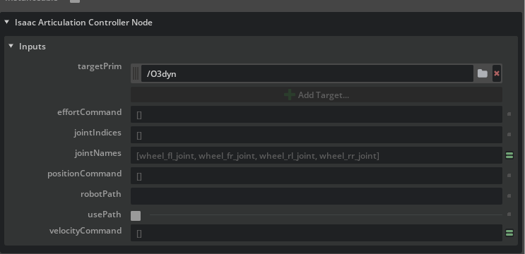

Our engineer found several problems of your USD file:
  1. The graph is missing the wheel joint names on the articulation controller
  2. It is missing the wheel radius, mecanum angles, wheel positions and orientations
  3. The wheel themselves are modeled as a single rigid body
Here is a reference how O3dyn is:
@zhengwang thanks for the response! About the joint names in the articulation controller, I thought the USD Holonomic Robot Setup node handles that by making a connection between DOF joint and Articulation Controller Joint Indicies? Also about the rigid body, what can I do in my URDF to change it so that the wheels are individually their own thing (and not a rigid body)?
also @zhengwang, the wheel radius, wheel orientations, wheel positions, and other stuff are all outputs of the node I’m having a problem with. I’m aware that the other two nodes do not have the inputs they need because the inputs they need come from the node that isn’t working (the USD Setup Holonomic Robot node). The thing that I was unaware of though was the rigid body modeling in problem 3. Do you have any guidance for how to fix that?
IMPORTANT UPDATE: Thanks everyone for your help, especially @zhengwang, but I ended up solving the problem on my own. It seemed to have nothing to do with the possible issues presented here. The problem was that my URDF was being imported as an instance or payload for some reason, which threw off the node’s traversal of the articulation tree.
FIX: Import the urdf in stage (not as a referenced file) so that its just treated as a prim without references or payloads (the robot prim didn’t have any arrow on it when I got it to work). From here, build the omnigraph as normal. It finally recognized the correct targets and worked fine.
