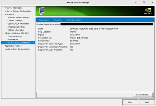

    So I can confirm what @michael.valenciav is reporting.
    I’m also on a Dell U3415W, with DP 1.2 enabled on the monitor I get something like the following output:
    cat /proc/asound/card0/eld#0.0
    monitor_present		0
    eld_valid		0
    cat /proc/asound/card0/eld#0.1
    monitor_present		0
    eld_valid		0
    cat /proc/asound/card0/eld#0.2
    monitor_present		0
    eld_valid		0
    cat /proc/asound/card0/eld#0.3
    monitor_present		0
    eld_valid		0
    However, after I disable DP 1.2 on the monitor, I get the following output on eld#0.1:
    monitor_present		1
    eld_valid		1
    monitor_name		DELL U3415W
    connection_type		DisplayPort
    eld_version		[0x2] CEA-861D or below
    edid_version		[0x3] CEA-861-B, C or D
    This is under the current drivers (390.25) and kernel 4.14.16-300.fc27.x86_64 on Fedora.
    I tried rolling back to earlier NV drivers, ie: 375.66, but it looks like it’s not able to run on 4.14. So I’m somewhat stuck here unless I want to run kernel 4.13.
    Any update from NV on this side or is it a kernel problem with DP 1.2 at this point?
    I confirm after disable dp 1.2 i have sound via dp 1.1
    and now you can see choice in the sound menu for dp/hdmi
    Something is wrong with nvidia drivers or kernel
    displayport 1.2 sound is broken
    Hmm, I thought I mentioned it earlier, but maybe I’m thinking of a different thread.
    Thanks for reporting this. Audio over DisplayPort multi-stream transport (MST) is not supported at the moment. There’s an enhancement request bug #1660108 filed to track adding it, and feedback like this helps us prioritize new features.
