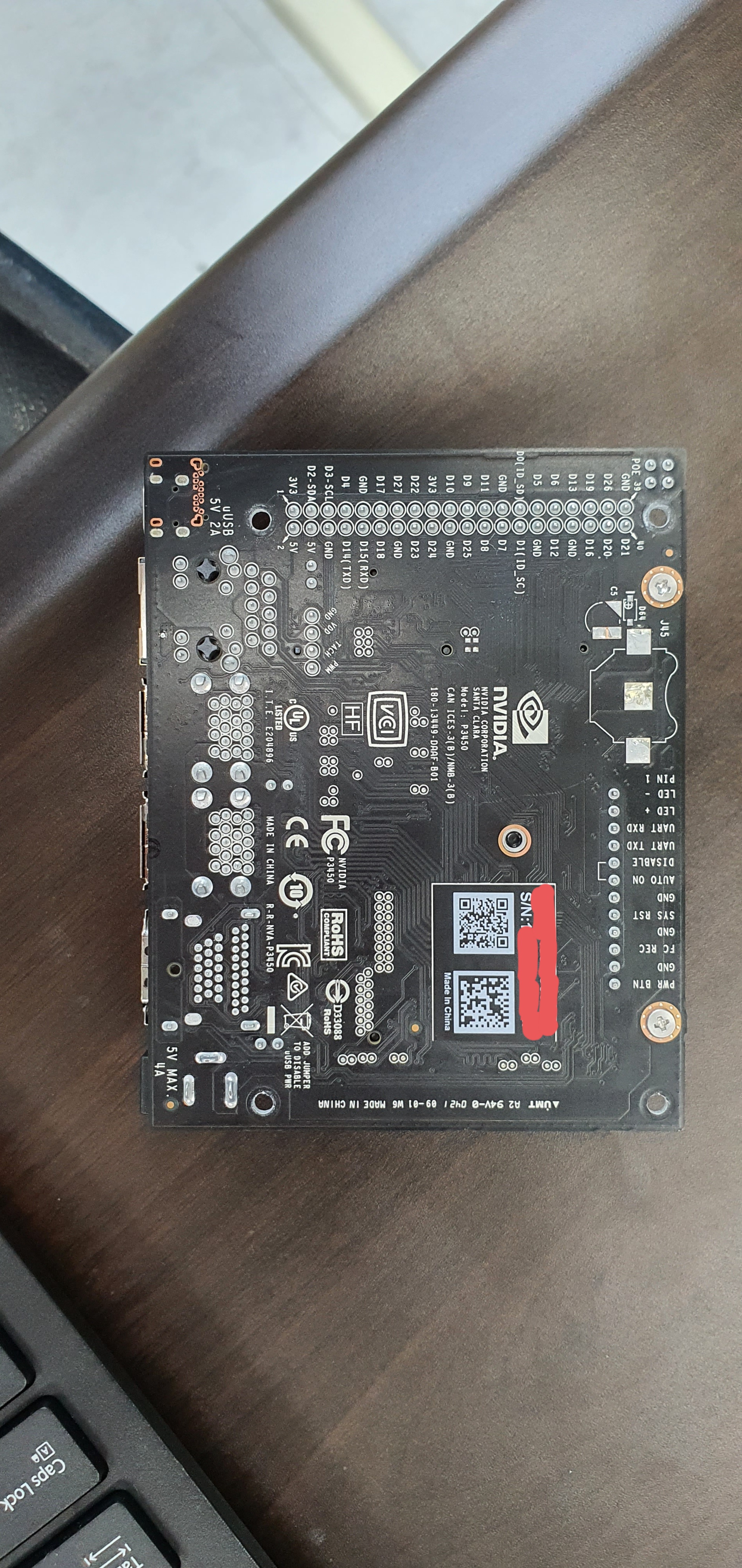

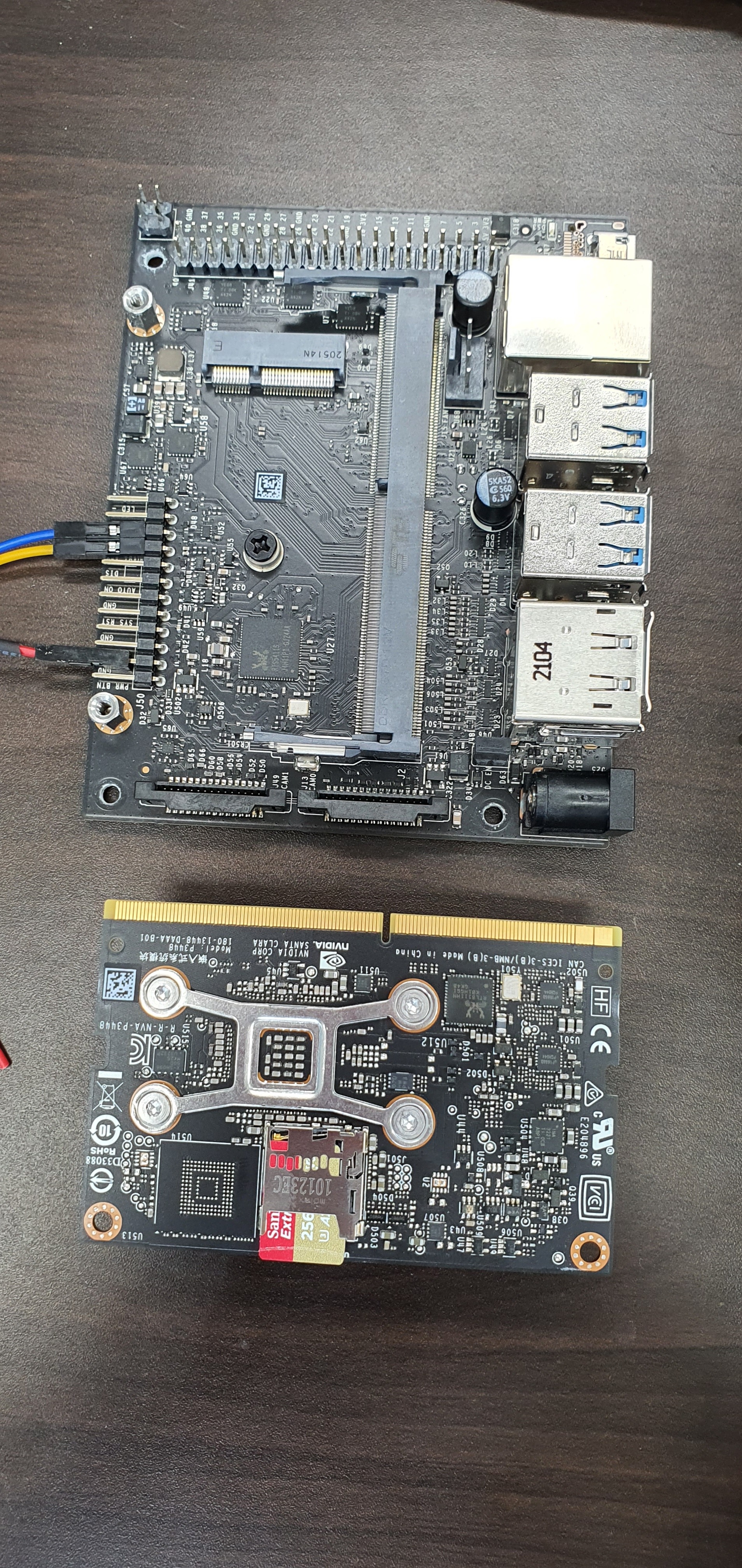

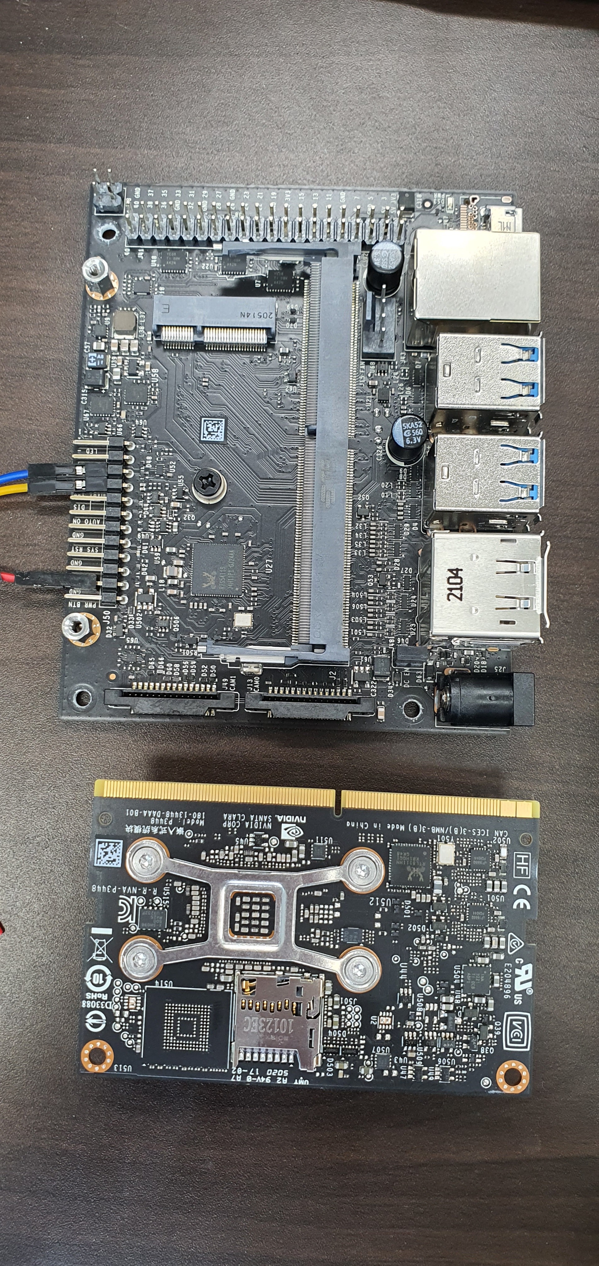

hi.
memory : sandisk extreme 256gb class3 a2
power : dc 5v 4a
model : NVIDIA Jetson Nano Development Kit-B01
iso : jetson-nano-2gb-jp451-sd-card-image
When a new image is executed for the first time, it does not go to the next screen after the logo.
There are many topics, but none of them help me. Current measurement is complete. A new image has appeared. I spend countless nights. every night every day.
help me.
Pls use following console to figure out what’s wrong:
i dont find. waht happen it.

Did you ever remove your module out from your carrier board?
I feel you are using jetson nano 2gb module on a 4GB carrier board.
not chage. new product.
Can you flip back your module and take a photo of the sticker on your carrier board?
