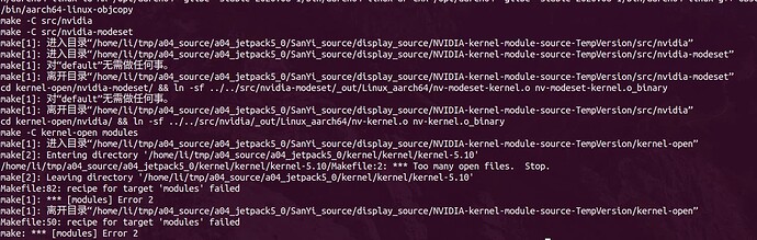

你好,下面是我的步骤:
1、解压kernel_src.tbz2,然后编译。
export CROSS_COMPILE_AARCH64_PATH=/opt/aarch64--glibc--stable-2020.08-1/
export CROSS_COMPILE_AARCH64=/opt/aarch64--glibc--stable-2020.08-1/bin/aarch64-buildroot-linux-gnu-
cd kernel/
./nvbuild.sh -o /home/li/tmp/a04_source/a04_jetpack5_0/kernel/kernel_out
2、解压nvidia_kernel_display_driver_source.tbz2,然后编译
 export ARCH=arm64
 export LOCALVERSION="-tegra"
 export CROSS_COMPILE=/opt/aarch64--glibc--stable-2020.08-1/bin/aarch64-buildroot-linux-gnu-
 cd NVIDIA-kernel-module-source-TempVersion
 make modules -j4 TARGET_ARCH=aarch64 SYSSRC=/home/li/tmp/a04_source/a04_jetpack5_0/kernel/kernel/kernel-5.10 SYSOUT=/home/li/tmp/a04_source/a04_jetpack5_0/display_out CC=/opt/aarch64--glibc--stable-2020.08-1/bin/aarch64-linux-gcc LD=/opt/aarch64--glibc--stable-2020.08-1/bin/aarch64-linux-ld AR=/opt/aarch64--glibc--stable-2020.08-1/bin/aarch64-linux-ar CXX=/opt/aarch64--glibc--stable-2020.08-1/bin/aarch64-linux-g++ OBJCOPY=/opt/aarch64--glibc--stable-2020.08-1/bin/aarch64-linux-objcopy
出现如下错误:
3、拷贝auto.conf文件
 mkdir kernel/kernel-5.10/include/config
 cp kernel_out/include/config/auto.conf kernel/kernel-5.10/include/config/
还是有编译错误
4、拷贝文件到kernel/kernel-5.10
cp kernel_out/*  kernel/kernel-5.10/
5、继续编译,错误如下:
请问应该如何解决这个问题。

你好。我这试着还是不行,你那有编译好的nvidia.ko, nvidia-drm.ko, nvidia-modeset.ko驱动文件吗,直接发我一份吧,谢谢。
We have verified the steps and it is working. What error is seen in your environment?
Maybe you can re-download all packages and try again. To construct a whole-new environment.
你好,我已经是下载的最新的source了,还是有下面的错误,如果你这有编译好的ko驱动文件,直接发我一份吧,谢谢。
你好,我这编译正常了,感谢。
