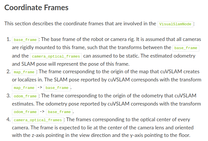

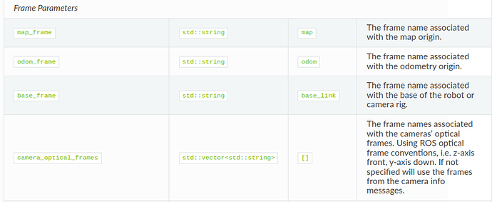

Perusing the cuVSLAM documentations, I see the following
and the coordinate frame definitions
cuVSLAM appears to be publishing odometry data with respect to two reference frames. One is published is map -> base_link and the other one is odom -> base_link.
Now from isaac_ros_nvblox ros parameter doc , this package is setup to publish map updates from global_frame -> pose_frame with those two parameters defaults being odom and base_link respectively.
