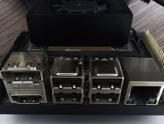

I have a Jetson Xavier NX Developer Kit, it was working fine with Jetpack 5, in the evening it was working fine, but the next day when I tried to Turn it ON, it was not showing the display, the power light was also not turning ON.
Physically the device is not damaged.
I checked the voltage with Digital Multimeter, and it shows the correct voltages (3V on 3V Pins & 5V on 5V Pins).
Lights on the ethernet port are also not turning ON.
I checked with a local technician, and he says this might be a problem with the jetson’s firmware (because the hardware is fine).
I am using the original charger (the image is attached at the end) that came with my Jetson.
Any help will be appreciated in this regard.
