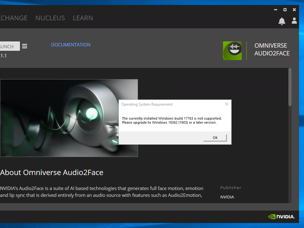

I have problmes running A2F in Amazon cloud- See the video please:
So first I open the Camilla with bado animation in create. It works ok.
Then I open the A2F scene where this exact same body is used. As you see it is totally crazy :)
Everything is workign ok at my local PC win 10 with A 6000 GPU.
But in Amazon AWS I get that body mesh totally wrecked.
Only difference in Amazon insances A2F is that it opens WITHOUT the example talking head:
And this Win 10 warning when I boot up:
But Create works there just fine…
Please help you can, this is a paid customer project.
Can you please provide the log file for your AWS session? It looks like extensions have failed to load.
Here are all these logs for you:
logs.zip (2.3 MB)

Thanks for the log files
The warning of Windows version does not meet the requirement in A2F app is correct as mentioned on this page Audio2Face Overview — Omniverse Audio2Face documentation
A2F app has different windows version requirement vs Create. There’s certain library used in Audio2Face extensions that require newer version of Windows. In the logs I can see A2E failed to load which causes the chain of extensions dependency on A2F failed to load.

The rabbit hole to solve it starts at Windows doc.
This assuming we wanna use Windows Server which we should for an Enterprise deployment.
Not gonna lie this is a major design flaw for A2F. Only supporting SAC branch and not supporting Linux distros.
