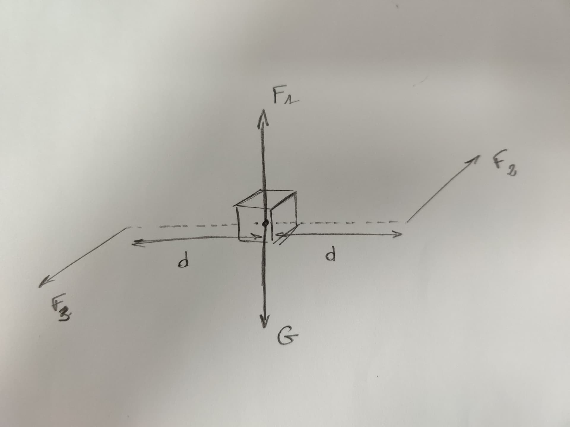

I am trying to implement boats in Isaac. To do so I need to apply torques to objects. However, as far as I am aware, Isaac does not offer any means to apply torques directly. Alternatively, one can apply torque to an object by applying a force at one meter from the Center of Mass of the object. Hence I tried to use the apply_body_force method from the dynamic control extension to apply torque to my objects. However, when I try to apply torques to some cubes nothing happens. It is as if the force where applied at the center of the object and not the desired coordinates. Is there something I am doing wrong?
Please find bellow the code we use to test this behavior.
Best,
Antoine

Hi Antoine,
I attempt to run your code and the apply_body_force seems to be applying the forces. Are you not getting any movement from the cube or not the intended movement?
Make sure to click on “Play” to enable the physics simulation, otherwise you won’t get to the physics_update method. You can either click on “Play” in the UI or do it programmatically with omniverse_kit.play() (in your code).
Once I do this, I start seeing the cube being moved.
I think the Physics Inspection (Isaac Utils → Inspect Physics) tool can be helpful to inspect what is going on with your cube as well. You can check its Position, Mass, Velocities, etc
To further debug parts of your code (like force intensity, position, effects of mass) you can also just run parts of it with the Script Editor (Window → Script Editor) on-demand vs having to re-run the script to change the physics_update method all the time.
Hi Teresa,
I am getting movement, but not the one expected. I’ll double check with the Physics Inspection tool. In my simulation the cube slowly lifts up, but is not rotating around z when it should be rotating around z.
So this is being applied:
dc.apply_body_force(rigid_body, [0,0,981.1],[0,0,0])
But it looks like these are cancelling each other as if they were applied at the same point:
dc.apply_body_force(rigid_body, carb._carb.Float3(1000,0,0),carb._carb.Float3(0,100,35))
dc.apply_body_force(rigid_body, carb._carb.Float3(-1000,0,0),carb._carb.Float3(0,-100,35))
Here is what it should look like:
Update, using the Physx API, the object has the expected behavior:
    def physics_update(dt: float):
        physxIFace = get_physx_interface()
        physxIFace.apply_force_at_pos(prims[-1], carb._carb.Float3([0,0,1000]),carb._carb.Float3([0,0,0]))
        physxIFace.apply_force_at_pos(prims[-1], carb._carb.Float3([1000,0,0]),carb._carb.Float3([0,100,0]))
        physxIFace.apply_force_at_pos(prims[-1], carb._carb.Float3([-1000,0,0]),carb._carb.Float3([0,-100,0]))
