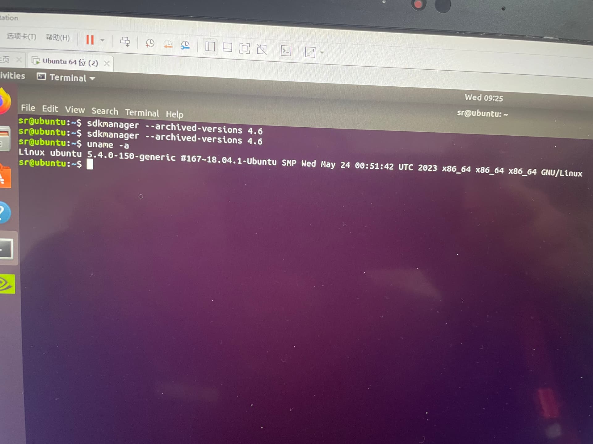

4.6 can not be upgraded, SDKmanager is not 4.6, can not install the environment, excuse me is there any good way, thank you

Please check Jetson Nano FAQ
Q: How to install old version JetPack from SDK Manager?
See also: Install downgrade Jetpack - Jetson & Embedded Systems / Jetson Xavier NX - NVIDIA Developer Forums

請問你的host PC在其他版本的jetpack是能安裝的嗎
我是說其他jetpack4系列 比方說32.7 ?
软件版本是:jetpack4.6, R32.6.1
我知道你的版本…我的意思是其他rel-32.7 or rel-32.5你有沒有試過…
如果你要等我們試, 你可能需要等一陣子
If this really is older JetPack, then the option “--archived-versions” probably is incorrect. The “hyphen” ‘-’ character in the middle was not added until later releases. Try this:
sdkmanager --archivedversions
(note the spelling difference)
那就請你用紅框裡面的command試試看阿…?
试过,也是不行。
用JP4.6 直接sudo apt-get update就会报错,感觉是源的问题,我刷过你们官方原生版本,也会有

ok. 我們這邊確認一下
这个问题比较急,客户想要4.6的软件版本,一直没有发布,还请加快验证一下,感谢
Have you tried “--archived-versions” without naming a version? Then selecting the specific version from the GUI?
yes,‘’sdkmanager --archived-versions‘’ donot update
What is the exact hardware you are working with, and what is the exact release you are interested in? Note that L4T is what actually gets flashed, and this is just Ubuntu plus NVIDIA drivers. The JetPack/SDK Manager release is the installer’s GUI, and just aids in the flash. The JetPack release is usually tied to the L4T release. Do you see your hardware listed here, along with the release you want?
https://developer.nvidia.com/linux-tegra
I ask because if you skip JetPack/SDKM, and work on command line, then you can do this:
Linux_for_Tegra/”.cd to “Linux_for_Tegra/rootfs/” you would unpack the “Sample Root Filesystem” with sudo.cd back to “Linux_for_Tegra/” and run this command:sudo ./apply_binaries.shYou are now ready to flash as much as you want on command line. The actual command depends on the hardware. If this uses an external media, it gets more complicated, but if this is purely a developer’s kit without external hard drive, then it is simple. If external media is involved, then there is an initrd flash required. If there is a third party carrier board, then this too probably requires modification.
Once done this will not install optional packages such as CUDA. This would have to be done correctly with a manual command. If you have customizations to the filesystem, then modifications can provide some very nice future simplifications.
Our network aused by network restrictions,now update,Thanks
