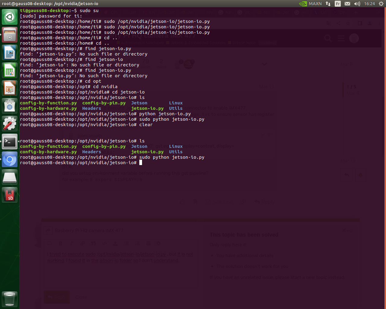

I tryed to execute sudo /opt/nvidia/jetson-io/jetson-io.py , but it is not working. I found it in the jetson-io folder so I don’t understand.
It actually launches and I can see the interface of “jetson-io”, but it doesn’t even last 1 second.
hello jules.lepaih,
may I know which Jetson Nano you’re using? this utility works with Jetson Nano 4GB only.
hence, you may revise the device tree to enable that.
please see-also Using the Main Platform Device Tree File.
