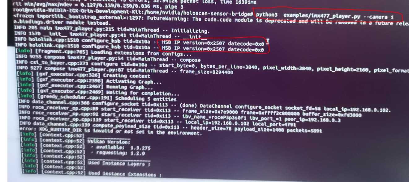

1、The connection diagram is as follows
connect the camera to J17 and connect Ethernet cables from IGX ORIN connectX-7 to J3.
2、Execute the following command
python examples/imx477_player.py –camera 1
For the same connection, use the following command:
python examples/linux_imx477_player.py --cam 1
can generate images normally.
May I ask how to solve this problem?
Can you provide the FPGA version and Holoscan SDK version you are currently using?
1、Holoscan SDK version is 2.2.1
2、FPGA version is 0x2506
Please use the latest FPGA IP version 2507 available here
This link:
It’s Lattice’s FPGA program, not Microchip’s FPGA program! I am using Microchip’s MPF200 development board here.
From this website: AN5522: PolarFire Ethernet Sensor Bridge for Nvidia Jetson AGX Orin Developer Kit AI Applications I downloaded the FPGA program again, burned it into the FPGA using a burning tool, and ran it again: python examples/imx477_player. py – camera 1 still cannot display images, the same phenomenon as before,And the execution:
python examples/linux_imx477_player. py – cam 1 also cannot display images.
Note: The device I am currently using is IGX ORIN
