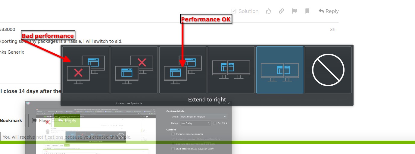

When running with my HDMI screen and the laptop screen (with brightness at 0 because i don’t need it in that configuration), both with the unified screen option, I have good performances.
But when I disable my laptop screen to just output to my HDMI screen, performance are abysmal.
