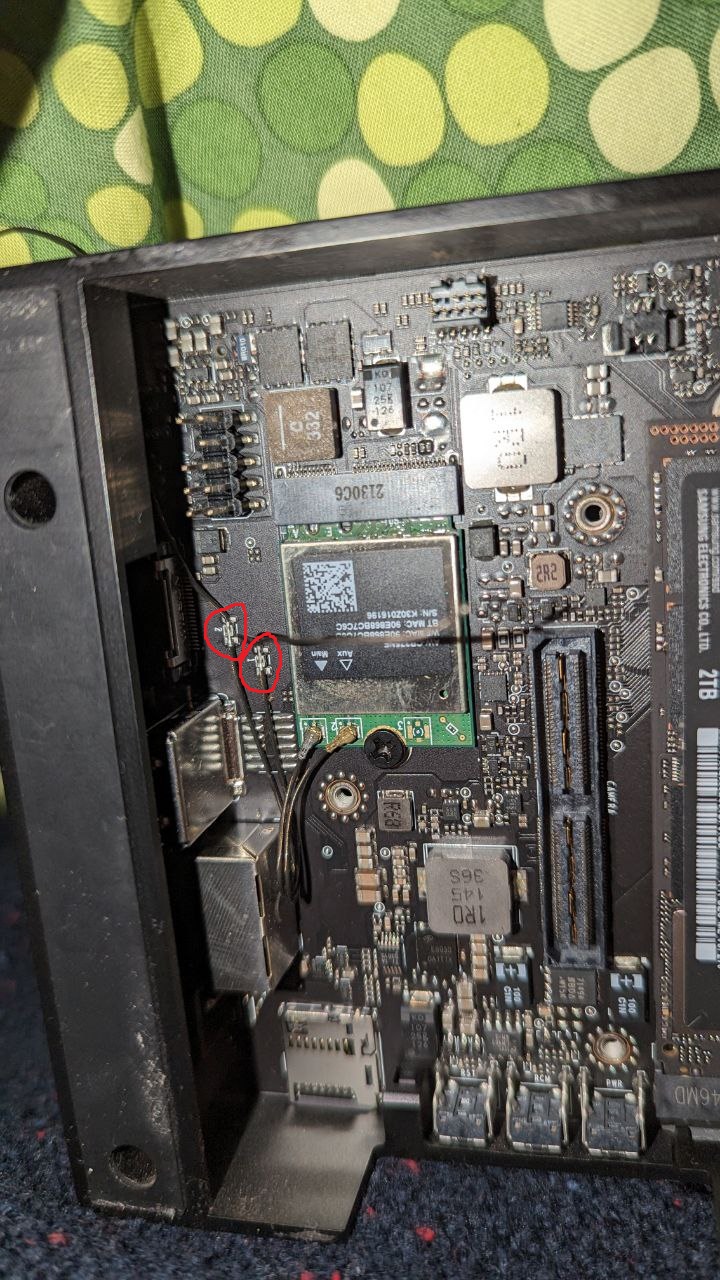

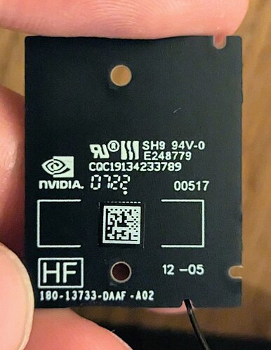

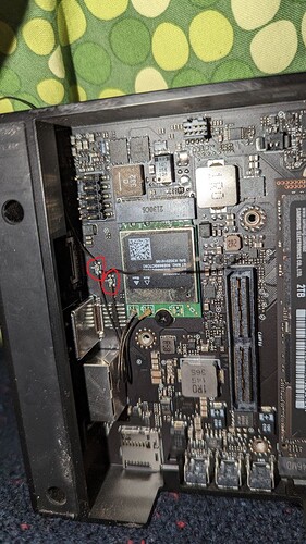

a student ripped apart one antenna cable of our AGX Orin development kit. I did not find a reference to the wifi specifications and therefore was unable to find a replacement for this exact cable. This cable also looks special, as it has some attachment points with to other PCBs inside of the jetson.
Could you help me find a suitable cable, that we can use to replace the original (as shipped) antenna cable?

It is not for sale. You can check with I-PEX for that. Its part number is 8-22-0155. The cable connetor is 20572-002R-08.
Thank you. Is the attachment point of the cable on the mainboard important for grounding or is it really just to fix the cable?
You mean the clamper? That’s mainly for fixing the cable.
