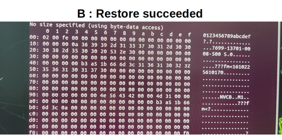

I am working with a custom carrier board and using three Jetson AGX Orin Industrial modules.
For convenience, I will refer to them as Module A, B, and C.
Using the l4t_backup_restore.sh tool, I successfully created a backup image from Module A and attempted to restore it to both Module B and Module C with the following command:
sudo ./tools/backup_restore/l4t_backup_restore.sh -e mmcblk0 -r custom.conf
The restore to Module B completed successfully.
However, the restore to Module C failed with the following output:

To investigate, I dumped the EEPROM contents of Module A, B, and C.
I noticed that the BOARDREV field is different between them:
  • Module A and B : S.0
  • Module C : P.0
My Questions are:
  1. Exactly what difference in Module C (compared to A/B) is causing the restore failure?
  2. What steps should I take if I want to restore the backup image from Module A onto Module C?

Which JetPack SW you’re using now?
I’m using JP6.1(L4T 36.4)
Module C is different spec to the module A/B.
If you want to restore the APP partition (rootfs), please refer to the below section
