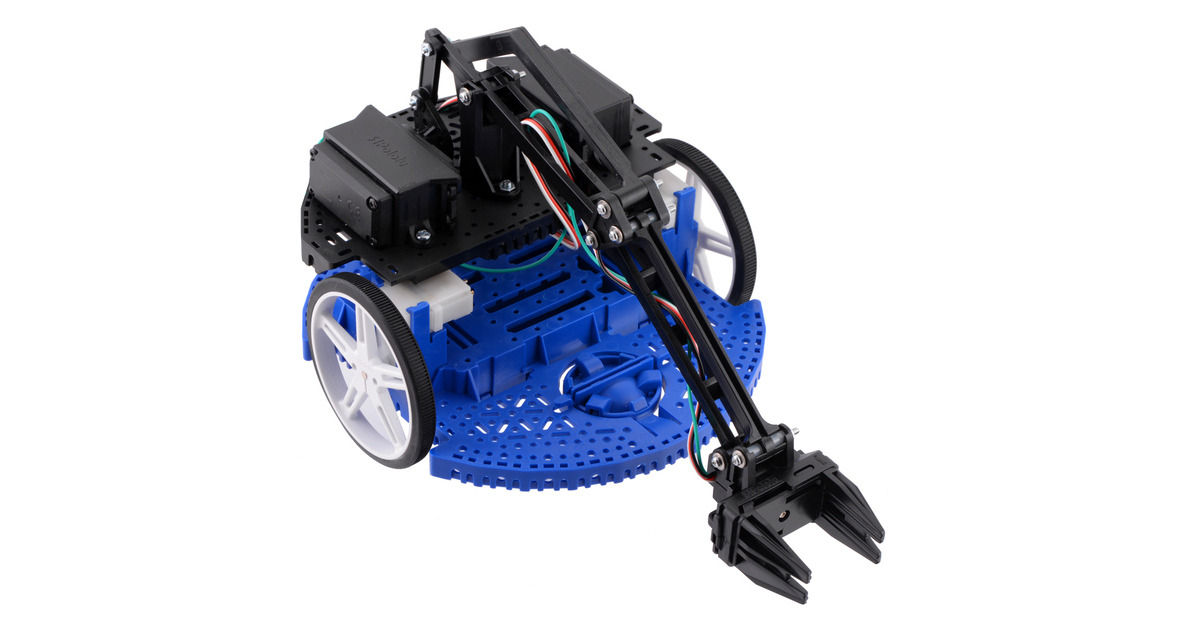

You might want to consider Pololu’s Romi chassis.
The Romi 32U4 Control Board is designed to interface to a Raspberry Pi, so it should be straightforward to get it working with a Jetson Nano.
