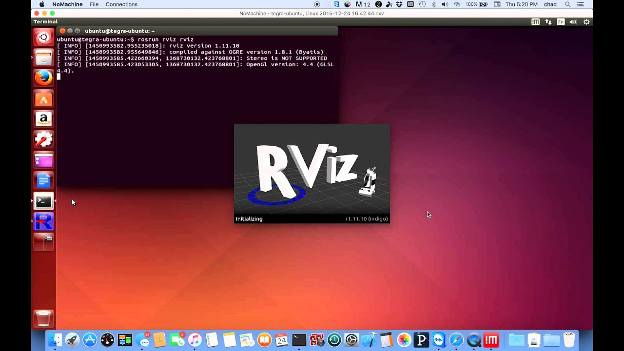

According to the official site there is an amrv7 version of x2goserver but I have yet to try it myself out of fear of breaking my distro.
It can be done however with nomachine
I’ve also found this GitHub - kapolos/armhf-x2go: Armhf binaries for x2go (ARMv7 - Ubuntu 14.04)
But I am too unsure of whether or not installing x2go server is safe for the jetson.
If you are unsure, just clone the root partition first (takes hours though). If it fails, restore via clone (takes minutes). See:
[url]http://elinux.org/Jetson/Cloning[/url]
I don’t actually see much risk of this breaking the Jetson, although it may not work with the particular desktop.
EDIT: The video is definitely from a JTK1, but it does seem you’ll need to get around the repository not having the ARMv7…you may find that other binary release URL does the job, but I have not tried.
