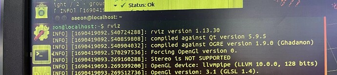

My Xavier NX is 16GB, and JetPack version is JetPack4.6.2.
When running RVIZ, we found that it didn’t work on the GPU, llvmpipe is used. It shows OpenGL Information as below:
274ac86d6f544a76051136ebd84323e
Can you help to find the cause of the problem, and try to slove or avoid it?

If the driver is ok, the Graphics information after the device restarts should be NVIDIATegra Xavier (nvgpu)/integrated, but now the Graphics is llvmpipe (LLVM 10.0.0, 128 bits) after the device is powered up.

Is this related to the jetson driver?
Hi xixi99,
Rviz depend on GPU or not should be configured on Rviz itself, I think ,maybe not supported actually, you should query this issue on ROS community.
and my concern is why run rviz on Xavier?
you can run it on host which in the same local network to monitor anything on Xavier.

This script is actually installing jeptack4.6.2… so it is suggesting you to reflash.
Reinstalled jetpack 4.6.2 still doesn’t work.
The jtop information on the customer board is as follows(it can work on this board, I don’t know if it is helpful):
After reinstalling the system and jetpack, only the root account can enter the desktop, and the Graphics(NVIDIA Tegra Xavier (nvgpu)/integrated) is ok.
But other accounts cannot enter the desktop.
What needs to be configured?
