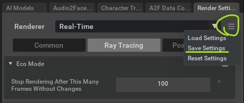

@petera3d i am just another OV user, but are you talking about the render settings or preferences? i am asking because Eco Mode toggle should be under render settings, and would help if you clarify the options you are wanting to change. if you are referring to the render settings, have you looked into the save/load presets?

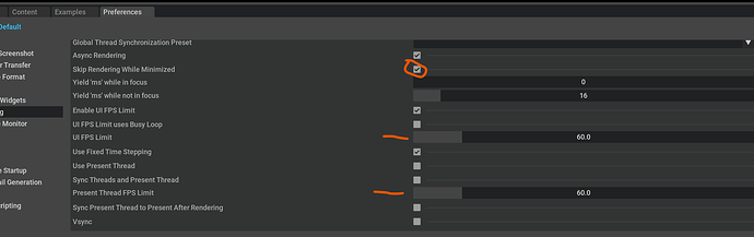

Yes, but I’m talking also about Preferences window. It seems that the settings are not saved permanently, based on my understanding.

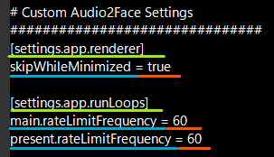

i see. try adding the snippet below to your audio2face.kit file (i appended after the last lines of #'s):
# Custom Audio2Face Settings
[settings.app.renderer]
skipWhileMinimized = true
[settings.app.runLoops]
main.rateLimitFrequency = 60
present.rateLimitFrequency = 60

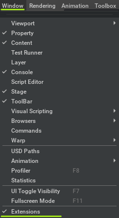

  1. go to Window > Extensions to bring up the extension manager.

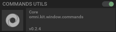

  2. enter ‘command’ into the search field and activate the Command Utils extension from the Extension Manager. this will help us see what params is being changed:

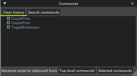

  3. you should now be able to open up the Commands extension through Window > Commands. this is essentially an ‘action recorder’ where you can keep track of the executions you’ve done while in a kit based app (such as A2F):
  4. so the idea is to record any preference changes you are making so we know what attributes/params to add into the .kit file. let’s first clear up the history because it can get cluttered up quickly. you can do this by clicking on the Clear history button:

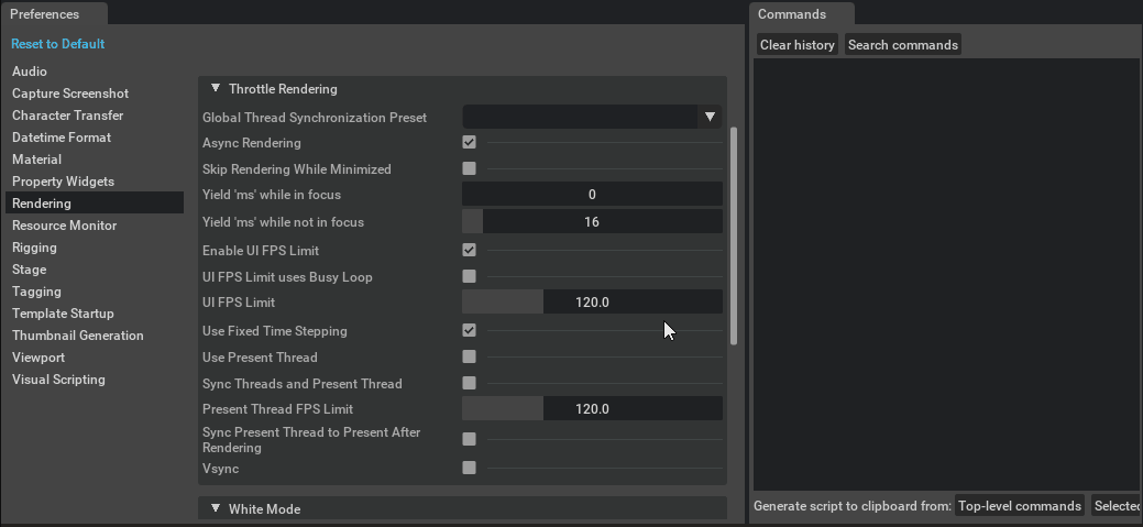

  5. open up your Preferences pallet and make an adjustment while the Commands extension is up, and you should see the records of the value changes. you can further expand each action to see the detailed param and value assignments by clicking on the + icon:
    PreferencesCommands

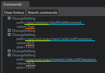

  6. so the next step is to specify in the .kit file which params we want to change and to what value; so a bit of coding is needed here. in short, i extrapolated the following info from the Commands extension: category (green), param setting (blue), and the value (orange):
  7. lastly, i followed the syntax from this file then applied those values accordingly in the audio2face.kit. resulting in the snippet i shared above. category will be inside brackets and preceded by settings as prefix, the rest should be more straight forward:

and finally, to apply the information shared above, you can actually set the EcoMode setting in the .kit file as well following the exact steps:
[settings.rtx.ecoMode]
enabled = true
feel free to give it a try.
Alternatively, you could consolidate them all under settings; whichever is easier for you:
[settings]
rtx.ecoMode.enabled = true
app.renderer.skipWhileMinimized = true
app.runLoops.main.rateLimitFrequency = 60
app.runLoops.present.rateLimitFrequency = 60

Thank you it works.
