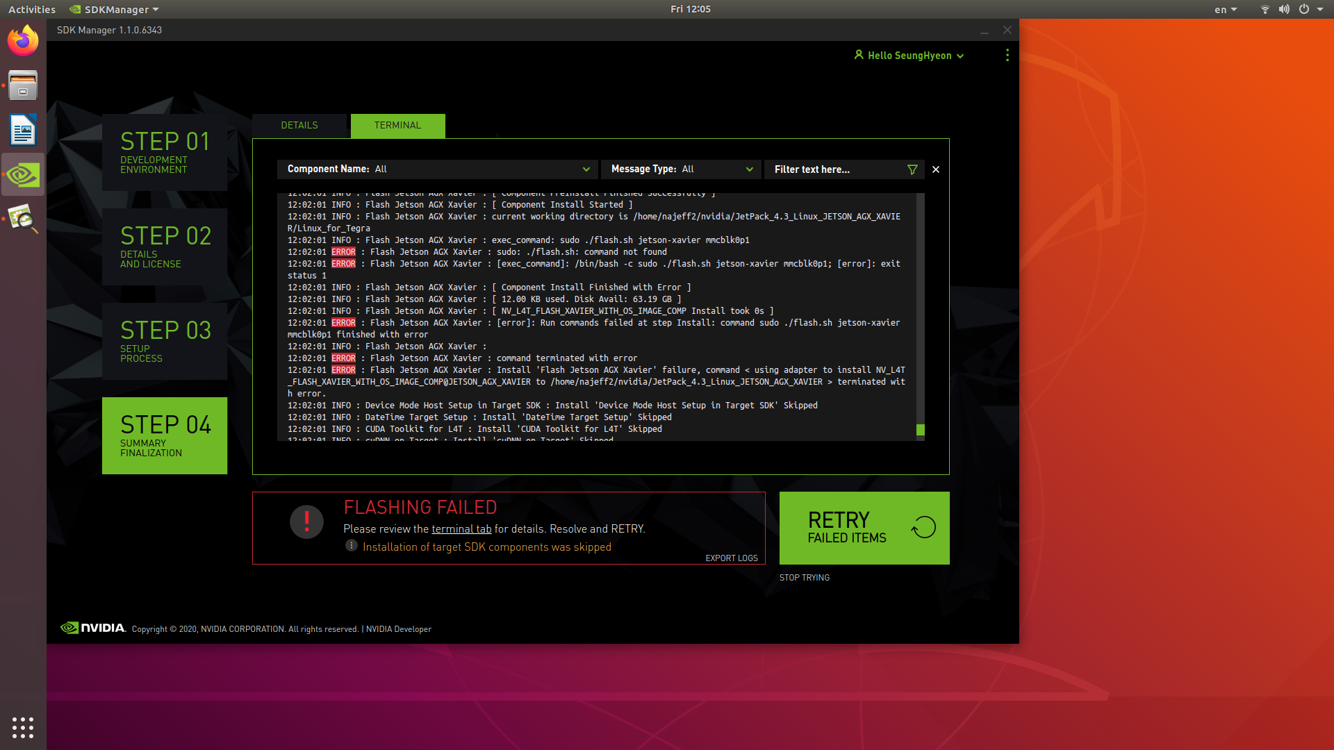

I tried to install the JetPack 4.4 with SDK Manager and One is successfully installed the JetPack 4.4 but the other one has some issues.
When I try to install the OS image to Xavier with SDK manager, I faced error.
( I changed the USB cable 3 times )
How can I solve this error?
the screenshot is
Terminal screenshot is ( onedrive link )

We need the flash log from both host and uart. Please directly use flash.sh to do the flash work instead of sdkmanager for now.
Also, are these two xavier new (out-of-box)? Have they been flashed by other jetpack before?

Looks like a hardware issue. Have you tried other version of sdkmanager?
For example, JP4.3/JP4.2.

I meant there are (maybe) something broken on this module.

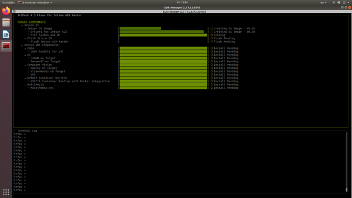

What is the output of the execution of the command below at the Host PC?
df -h
Did you try uninstalling the installation made with sdkmanager, the sdkmanager, also removing downloaded folders and reinstalling it again? Did you try using other versions than DP_4.4? Did you try headless sdkmanager e.g. as in the example below?
sudo sdkmanager --cli  install --user youruseremail@youremail.com --logintype devzone --product Jetson --version DP_4.4 --targetos Linux --target P2888 --flash all --targetimagefolder /home/username/Downloads/nvidia/installation_agx --downloadfolder /home/username/Downloads/nvidia

is the df -h
showing the state after you got the headless sdkmanager or before it?
61 Gb available is a corner state which would work, if you run the headless install.
On the other hand if you previously run GUI sdkmanager it could cause shrink of the space up to 30Gb which wouldn’t be redundant for running the latter.

Could you always post the uart log during flash when we are dealing with flash problem?
To be honest, I don’t like to see sdkmanager when we are debugging. Though I understand sdkmanager is a NV official tool, it has too many unrelated stuff and logs which we don’t need to check.
In my own point of view, I always use flash.sh and dump uart log to debug such problem.
I see all partitions are mounted in a snap subdirectory. If this is being flashed from a container, then this can cause USB failure.
