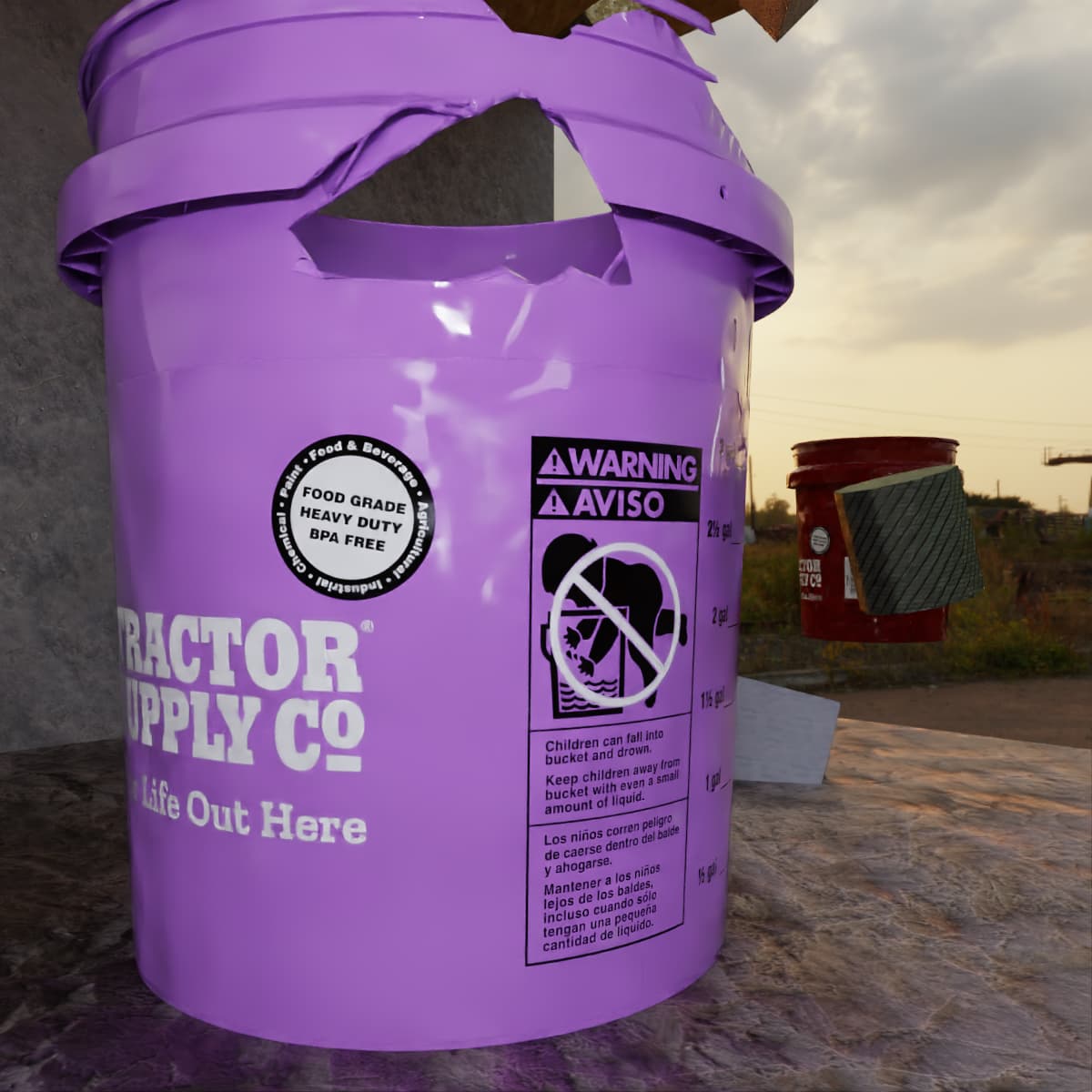

We need to train our AI to detect contaminant defects on our product that can be underneath our transparent label. We want to be able to segment these without the label getting in the way. We know that we could use the cutout_opacity parameter of the material’s geometry to completely hide parts of the label, but this as photorealistic as parts of the label being transmissive. I have included a screenshot of this as an example. One way we thought of to fix this was to set only that part of the label with content to have semantics and to make the rest “invisible” to semantics in a way. Is this possible in MDL? We also tried setting the “invisibleToSecondaryRays” and “doNotCastShadows” flags, but these just make the entire label completely invisible in the segmentation. Is this intended behavior and, if so, is there an elegant way to hide only transparent areas in the segmentation? Our current, albeit hacky, solution is to step Orchestrator twice to get the segmentation first and the RGB second. If this is the best solution, is there at least a way that we could disable the RGB or the segmentation render? To my knowledge, even when we only use the RGB output, the segmentation view will still get rendered and vice versa. Another solution we thought of was to separate our label into two meshes, one containing just the content and the other containing everything else, but it would be nice if we could leave the label in one piece. One final question: is there any way to make an object visible only to secondary rays and invisible to all others?
MDL materials can have a semantic, but you’d still run into the issue of needing to make the rest of the label material invisible to the semantic mask, which currently is controlled by the “doNotCastShadows” on the geometry as you mentioned.
“doNotCastShadows” to remove semantic consideration is intended behaviour, and used for cases like window panes where you want the semantic information, because the RGB basically shows a mostly transparent window.

Good to know! Is there some way we could assign “doNotCastShadows” to one part of the mesh and not another or some part of a material and not another? For example, make the transparent part of our label have “doNotCastShadows” selected and the content of our label have it unselected thereby making only the content/text segmented and still allowing for the transparent look of the label rather than using “cutout_opacity”.
Not to my knowledge. “doNotCastShadows” is a mesh prim attribute. I’ll see if I can pull over the MDL experts’ ear see if they know more.

I think the double orchestrator approach, or some procedural projection material approach is the surest way for now. There’s also multi-matte, but its completely outside the SDG pipelining, but I thought I’d mention it here incase it sparks some ideas.
