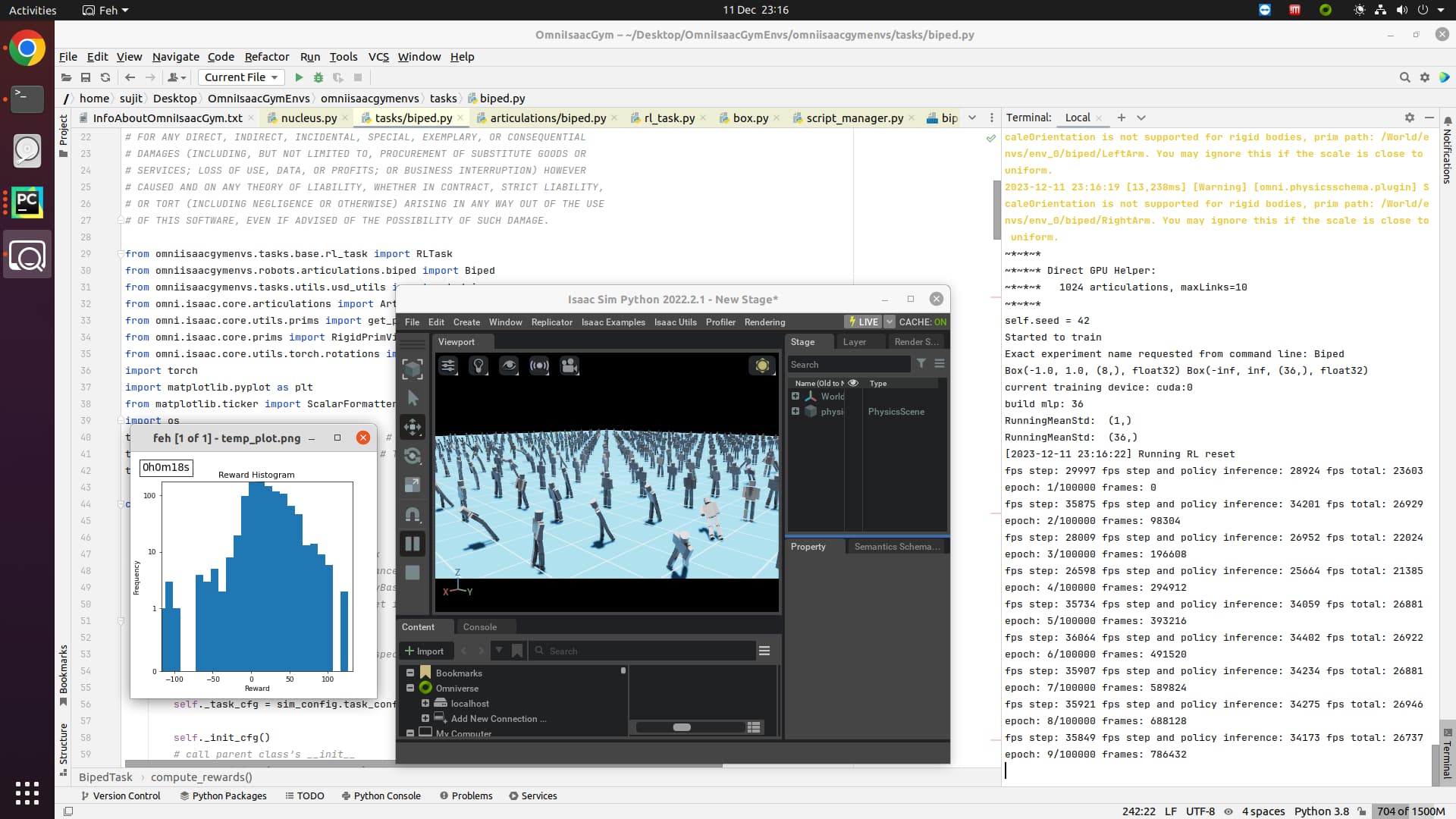

sorry didn’t see your post before..I have Isaac sim rl’s and use pycharm as my IDE for more than a year now and it works great but as issaac sim.
Im running in ubuntu, I think you are overthinking the interpreter as its going to direct to the python interpreter within omniverse anyway so it doesn’t actually matter too much - see below for my case in point
here my configuration
interpreter for isaacSIM 2022.2.1
/usr/bin/python3.8
and interpreter I use for 2023.1.0
/home/sujit/.local/share/ov/pkg/isaac_sim-2023.1.0/kit/python/bin/python3.10
next, open a terminal in Pycharm and cd to your isaacgymenvs directory
e.g. ~/Desktop/OmniIsaacGymEnvs/omniisaacgymenvs
you can then run an example using
/home/sujit/.local/share/ov/pkg/isaac_sim-2022.2.1/python.sh scripts/rlgames_train.py task=Cartpole
a more complex example
/home/sujit/.local/share/ov/pkg/isaac_sim-2022.2.1/python.sh scripts/rlgames_demo.py task=AnymalTerrain num_envs=64 checkpoint=omniverse://localhost/NVIDIA/Assets/Isaac/2022.2.1/Isaac/Samples/OmniIsaacGymEnvs/Checkpoints/anymal_terrain.pth
You can also directly run isaac sim bypassing the omniverse launcher in case you have any authentication problems
/home/sujit/.local/share/ov/pkg/isaac_sim-2022.2.1/isaac-sim.selector.sh
/home/sujit/.local/share/ov/pkg/isaac_sim-2022.2.1/isaac-sim.sh
I presume it should be very similar with Windows but I prefer a linux environment
Here is screenshot of it all running
