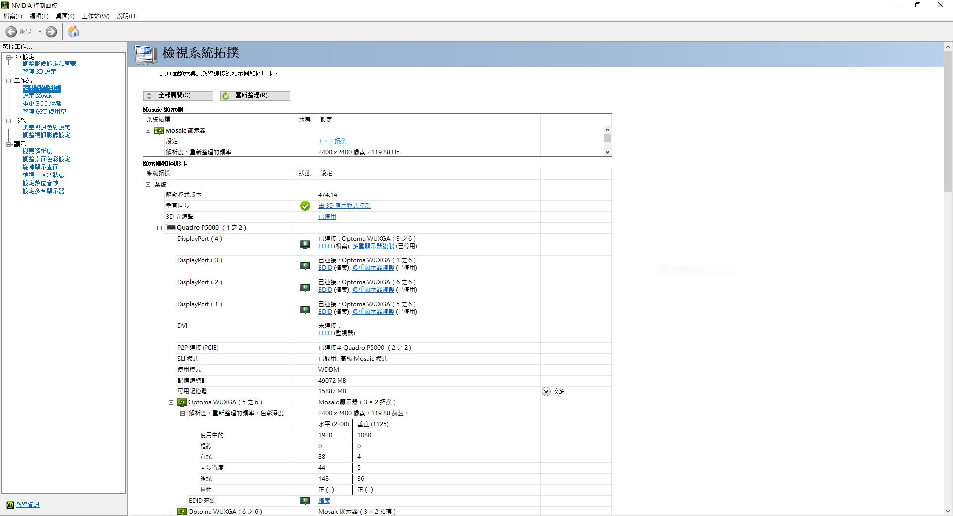

I encountered the same problem when I applied mosaic and warping via NVAPI. First of all, I set the timing of 6 displays to 1280x800 120hz and then applied a 3x2 mosaic resolution of 2400x2400 120hz with warping mesh for each display. However, after applying NVAPIs, displays output changed to 1920x1080 120hz.
Could you please advise me on how to maintain the display output resolution after applying mosaic via NVAPI?

Thanks for the reply, I use 2x Quadro P5000 in SLI ( Nvlink Bridge ) with 6x 1280x800 120Hz Projectors.
If I change projectors resolution to 1920x1200 60Hz, all displays output resolution are correct (1920x1200) after Mosaic applied.
Here is the code for theMosaic setting

The result after trying the command line is incorrect.
The Mosaic resolution has changed to 3840x1600 at 120 hz.

I used the following parameters to set NvAPI_Mosaic_SetDisplayGrids: rows=3, columns=2, displayCount=6, displays.overlapX=160, displays.overlapY=0.
The result with mosaic setting is currently at 2400x2400 120Hz, but each display outputs at 1920x1080 120Hz.
If I reset mosaic setting, each display outputs change to original timing 1280x800 120Hz
