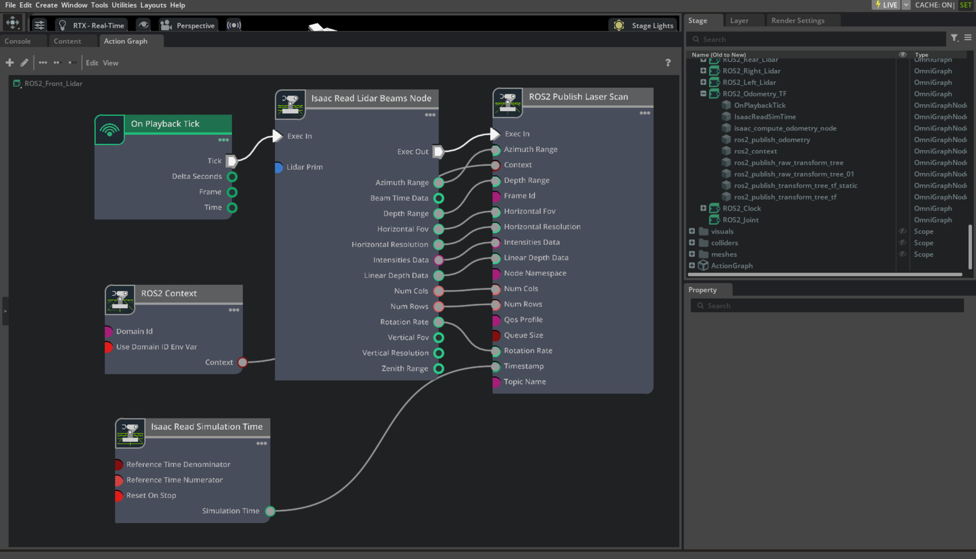

Tf to Lidar transform issue in rviz2
[ERROR] [1768598091.089770744] [rviz2]: Lookup would require extrapolation into the future. Requested time 778.049940 but the latest data is at time 777.966707, when looking up transform from frame [lidar_front] to frame [base_link]
Can anyone tell me how to solve this issue?
Thanks for reporting this! I can see from your screenshots that you have the clock graph set up correctly.
Could you double-check that use_sim_time is set to true in your launch configuration? This is a common cause of timestamp mismatches between Isaac Sim and RViz2.
