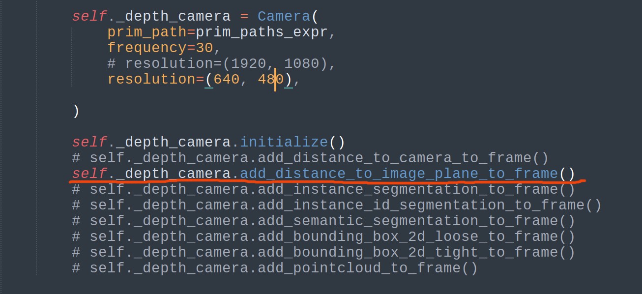

There is distance_to_camera and distance_to_image_plane. Could it be that the wrong data format was used?

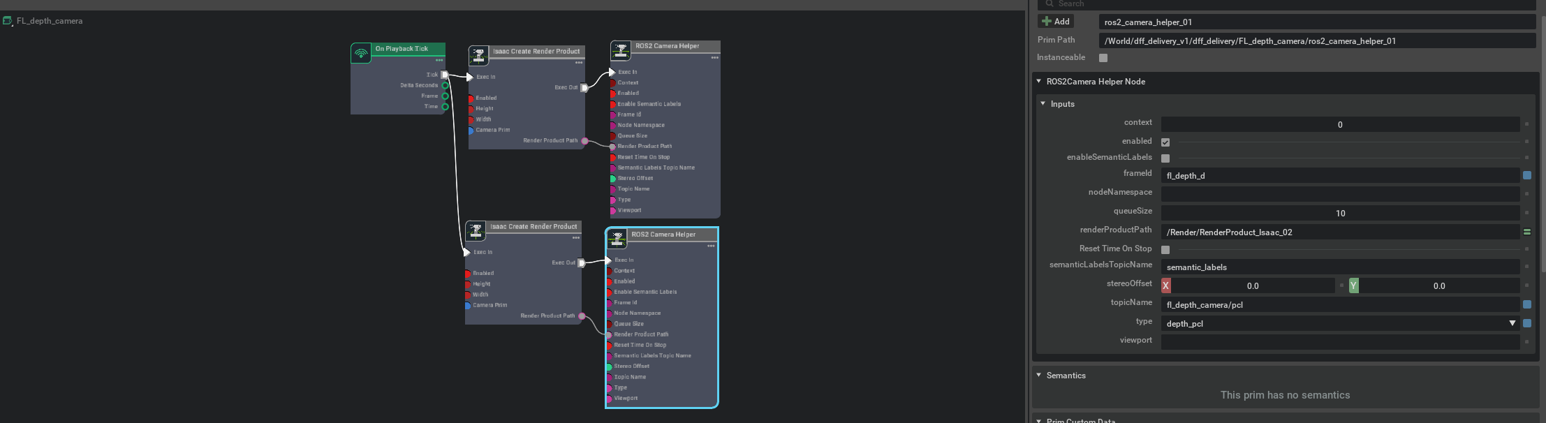

I’m trying to simulate Intel RealSense D455 camera (I use standard D455 camera rig from Isaac). I want to publish point clouds from camera to ROS2 utilising the OmniGraph, see the screenshot below:

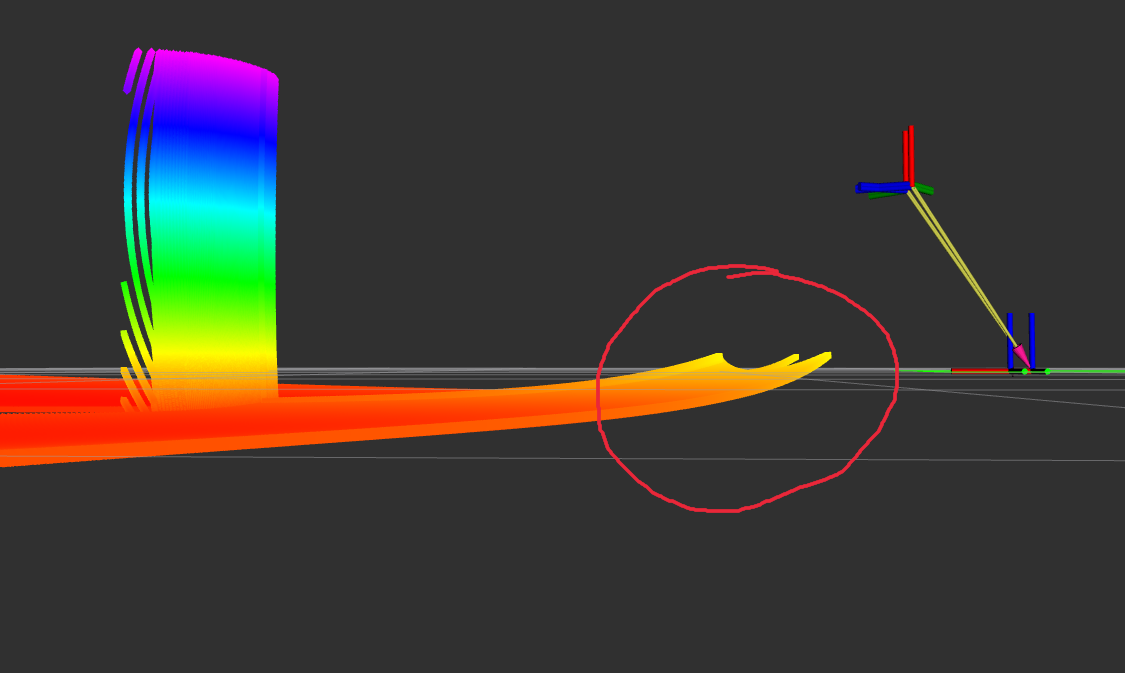

When I visualising point cloud in RViz, it seems distorted:
It seems like I should add a rectification node before ROS2 camera helper, but I have no ideas how to do it.
Hi! @pavel.butov , I resolved the problem by replacing distance_to_camera with distance_to_image_plane. It can get the correct rgb-d heightmaps and the correct point clouds.
@Weylon2023 thank you for your feedback! Could you please give me some more details? Where should I replace it (would you be so kind as to attach a screenshot or something)?
Hi, @pavel.butov , I made modifications in my settings for the camera, after initialization, you could define some APIs to get information via the camera.
