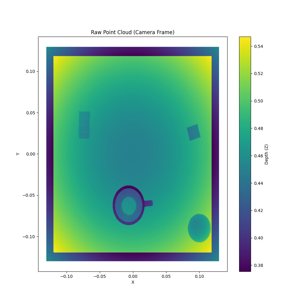

I am trying to obtain the point cloud from the depth camera. The camera has an orthographic projection view. As can be seen in the attached pictures, the point cloud obtained through my transformations results in a yz arch in both depth and point cloud. I feel that the transformations are wrong but fail to see how. If anyone has gone through this or maybe, better yet, has an alternative solution, I would be grateful.

I have tried using both the distance and the depth image as input for the get_pointcloud() function

def get_pointcloud(color_img, distance_img, cam_intrinsics, is_orthographic=True):
    """Convert RGB-D images to a 3D point cloud.
    Args:
        color_img: RGB image (HxWx3)
        distance_img: Distance image (HxW) or depth image
        cam_intrinsics: Camera intrinsics matrix (3x3)
        is_orthographic: Whether the camera uses orthographic projection
    Returns:
        points: Nx3 array of 3D points
        colors: Nx3 array of RGB colors
    # Get image dimensions
    im_h = distance_img.shape[0]
    im_w = distance_img.shape[1]
    # Convert distance to depth if needed
    depth_img = depth_image_from_distance_image(distance_img, cam_intrinsics)
    # Project depth into 3D point cloud in camera coordinates
    pix_x, pix_y = np.meshgrid(
        np.linspace(0, im_w - 1, im_w), np.linspace(0, im_h - 1, im_h)
    if is_orthographic:
        # For orthographic projection, the x and y coordinates are directly proportional
        # to the pixel coordinates, and don't depend on depth
        fx = cam_intrinsics[0, 0]
        fy = cam_intrinsics[1, 1]
        cx = cam_intrinsics[0, 2]
        cy = cam_intrinsics[1, 2]
        # Calculate world coordinates (flat plane, no perspective)
        cam_pts_x = (pix_x - cx) / fx  # Scale by focal length but don't multiply by depth
        cam_pts_y = (pix_y - cy) / fy
        cam_pts_z = depth_img.copy()  # Z is just the depth
    else:
        # For perspective projection
        cam_pts_x = np.multiply(
            pix_x - cam_intrinsics[0][2], depth_img / cam_intrinsics[0][0]
        cam_pts_y = np.multiply(
            pix_y - cam_intrinsics[1][2], depth_img / cam_intrinsics[1][1]

    # Debug: Save raw point cloud before any transformations
    plt.figure(figsize=(10, 10))
    plt.scatter(cam_pts[:, 0], cam_pts[:, 1], c=cam_pts[:, 2], cmap="viridis", s=1)
    plt.colorbar(label="Depth (Z)")
    plt.xlabel("X")
    plt.ylabel("Y")
    plt.title("Raw Point Cloud (Camera Frame)")
    plt.savefig("raw_point_cloud.png")
    plt.close()

    carb.log_warn(f"Camera pose matrix:\n{cam_pose}")
    # Convert distance image to depth image
    # Create point cloud using Open3D
    surface_pts, color_pts = create_point_cloud_with_open3d(
        color_img, depth_img, cam_intrinsics, transform=cam_pose
    if surface_pts is None:
        carb.log_error("Failed to create point cloud with Open3D")
        return None, None
    carb.log_warn(f"Point cloud shape: {surface_pts.shape}")

    def set_camera(self):
        # Position camera 1m above the front platform, facing downward
        overhead_position = np.array([0.5, 0, 0.5])  # Centered above the platform
        overhead_orientation = np.array(
            [0.5, -0.5, 0.5, 0.5]
        )  # Facing downward (90 degrees around X-axis)
        perspective_position = np.array([1.0, 0, 0.5])  # Centered above the platform
        perspective_orientation = euler_angles_to_quat(
            np.array([np.pi * 2, np.pi / 2, np.pi])
        # Create the camera
        self.camera = Camera(
            prim_path="/World/OverheadCamera",  # Unique prim path
            frequency=20,
            resolution=(540, 540),
            position=overhead_position,
            orientation=overhead_orientation,
        self.camera.initialize()
        APERTURE_SIZE = 0.5
        self.camera.set_projection_mode("orthographic")  # Set orthographic projection
        self.camera.set_focal_length(1.93)
        self.camera.set_focus_distance(4)
        self.camera.set_horizontal_aperture(APERTURE_SIZE)  # Set horizontal aperture
        self.camera.set_vertical_aperture(
            APERTURE_SIZE

def get_height_at_position(self, rgb_image: np.ndarray, distance_image: np.ndarray, camera: Camera, position: np.ndarray) -> float:
        """Get the height at a specific position using the depth camera.
        Args:
            camera (Camera): The camera object to capture images from.
            position (np.ndarray): The world coordinates (x, y) to measure height.
        Returns:
            float: The height at the specified position.
        self.heightmap_resolution = 0.001
        # Get camera intrinsics and pose
        cam_intrinsics = camera.get_intrinsics_matrix()
        cam_position, cam_orientation = camera.get_local_pose()
        carb.log_warn(f"cam_position: {cam_position}, cam_orientation: {cam_orientation}")
        # Convert quaternion to rotation matrix
        rotation_matrix = R.from_quat(cam_orientation).as_matrix()
        # Construct the full transformation matrix
        cam_pose = np.eye(4)
        cam_pose[0:3, 0:3] = rotation_matrix
        cam_pose[0:3, 3] = cam_position
        # Compute the heightmap
        # Capture the current frame
        frame = camera.get_current_frame()
        # Extract RGB image
        rgb_image = frame["rgba"][:, :, :3]
        # Extract and process distance image to get depth image
        distance_image = frame["distance_to_camera"]
        _, depth_heightmap = get_heightmap(
            rgb_image,
            distance_image,
            cam_intrinsics,
            cam_pose,
            self.workspace_limits,
            self.heightmap_resolution,
        # Convert the world position to heightmap pixel coordinates
        pixel_x = int(
            (position[0] - self.workspace_limits[0][0]) / self.heightmap_resolution
        pixel_y = int(
            (position[1] - self.workspace_limits[1][0]) / self.heightmap_resolution
        # Get the height value from the heightmap
        height = depth_heightmap[pixel_y, pixel_x]
        return height
