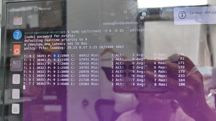

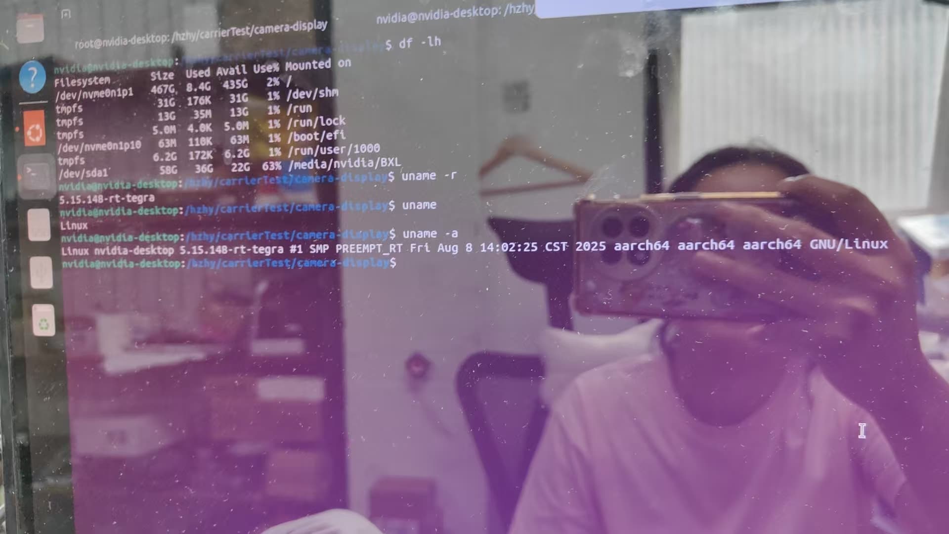

I used the agx orin 64G core module and installed the system on an SSD. I have applied the RT real-time kernel patch. I would like to ask, why is the maximum value of the real-time scheduling performance of my system not below 90us?
Would like to ask what the reason is for this, and how can we ensure that the maximum delay is below 90 us?

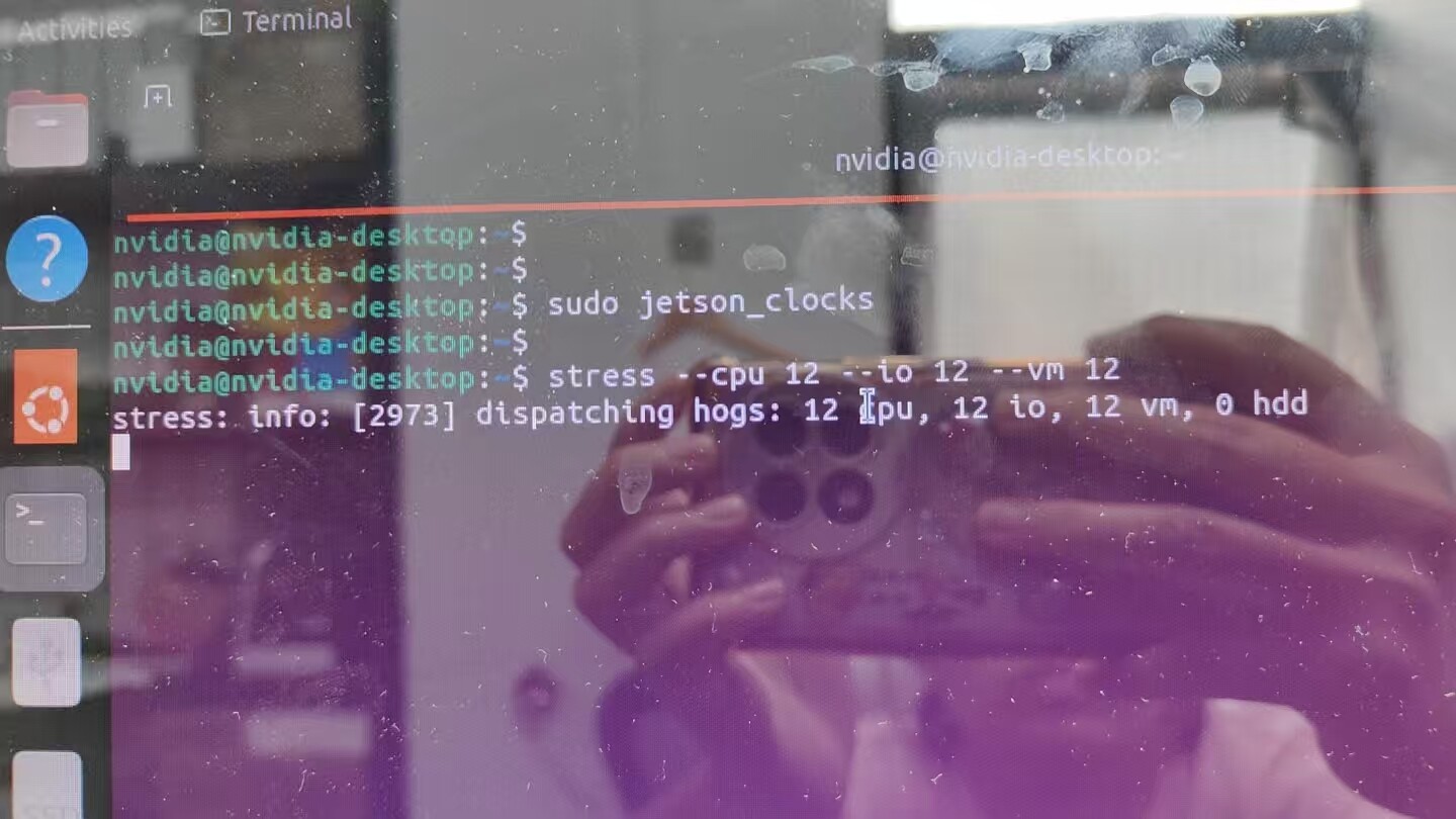

Before the “stress --cpu 12 --io 12 --vm 12” command was executed. My maximum delay is also around 1000 milliseconds.
After implementation, there was indeed a significant improvement. As shown in the above picture, the maximum delay was around 200.
What I want to ask is, is this the ultimate limit for me? Why not values within 90 microseconds?

I’m currently only in the testing phase and not yet in the actual usage process. Our clients have requested that our real-time performance be within 90 microseconds. I would like to know why, after applying this patch that adds a real-time kernel, the real-time performance does not fall within this 90-microsecond range.
I haven’t enabled the swap space.
No ARM Cortex-A architecture is capable of hard real time. You have to get ARM Cortex-M or Cortex-R. For anything beyond simple situations you’d need Cortex-R.
Consider why a simple microcontroller (Cortex-M) handles only a few processes. The time it takes to schedule and context switch itself goes up rapidly depending on the number of processes. The Cortex-R still has this issue, but it also has hardware capable of assisting that scheduling and works to more complex loads.
Cache is an enemy. You won’t have this is Cortex-M or Cortex-R in any location where timing must meet some spec. Sometimes people will run supposedly real time on a desktop PC, but this is usually wrong. In the cases where this might succeed the cache is disabled. Jetsons have cache, and mostly would suffer greatly in average speed if you disabled cache (and I think not all of the Cortex-A cache of a Jetson can be disabled). This though helps you reach the 90 uS if cache is enabled…at least when there is a cache hit. This is greatly harmed in the case of a cache miss because now the cache has to be refilled before it can be used.
