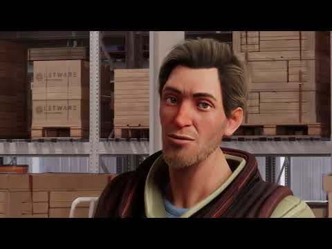

I found out this high quality warehouse!
I exported into Omnvierse, looks awesome!
But I just cannot find the setting in RTPT that would make it overall as bright ( global illumination ) as path traced, please see here:
Also can you see how much more lifelike the plastic wrapping is on Path Traced rendering.
What setting on RTPT might effect on that part. Now the plastic is very dark..
Pekka Varis
Hey! I used the settings I had tweaked for my character Paul for RTPT ( the one with the ghosting hair material heh )
It looks bright and very very good!!!
This is so freaking excellent rendering engine.
The plastic around on fab UE assets is a bit too invisible now but I can tweak the material..

If it seems too dark just adjust the exposure a little.

We cannot replicate this issue in the new 108, so it must have been fixed, whatever it is. You have not indicated your GPU. Is it an Ada 6000?
You said that if you cranked up all of settings, you resolved the issue. Is that still the case?
Are you talking about the hair ghosting?
Yes.
When settings are cranked up I get this:
Ok so I looked at the scene myself and it is definately something to do with that “RectLight” that he walks into after frame 2000. If you turn that off, it is perfect. Not sure why that is causing an issue. You are trying to highlight the edge of the hair with an extreme rim light effect, and it does not like it.
Thanks Richard!
I turned of the strong rim light, but still there is visible ghosting from the dome light, that is not extreme bright:
Then I rotated the dome so it does not hit his hair with straight sunlight. It helps a lot but still there is visible ghosting:
So its something with this hair material after all. I hope you and the RTX team have time to study this issue more? Also great to know Kit 108 is coming!!
Yes we are looking into this. It is something to do with the hair and our motion vectors for RTX Realtime 2,0. We will try to fix it for 108.
