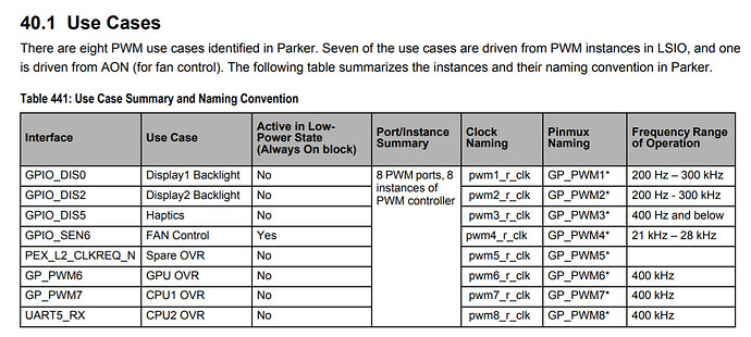

please dont use PWM6. Is it coming out of the CVM module for you to use?
PWM6 is used internally for OVR regulator to generate RAMUP power supply for SOC DVFS.
PWM7 also is out of bound.
Please check pinmux sheet and schematic before repurposing any pin
Sorry that I didn’t notice this. If you want to use LCD1_PWM_BKLT, then you should not use pwm6.
Below snippet is from the pwm. Please check this section and pick up the correct pwm you want to use.
Still I ask again, please answer this! This simple question is taking Nvidia months to answer!
what pwm is connected to pinmux 0x0c03010a8
What is the correct pinmux for LCD1_BLKT_PWM and what is the correct pwm? for LCD1_BLKT_PWM
Terry
0x0c03010a8 is the LCD1_BLKT_PWM. This is correct.
Now which pwm is for LCD1_BLK_PWM, you have never said!
Use these two tables and you should be able to use pwm3 for that pwm.
Please explain how you get pwm3 from these two tables, where do I find the LCD1_BLKT_PWM to tegra_pwm mapping?
I will try pwm3, thanks,
Terry
Open your pinmux spread sheet. This line will tell you this pinx is GPIO_DSI0.
Or just checked @JerryChang’s comment above. He already told you the pin GPIO_DIS5.
Then, check the table from TRM, which I posted above. You should be able to get pwm3.
you need to use the spread sheet and the two tables to get the right information.
