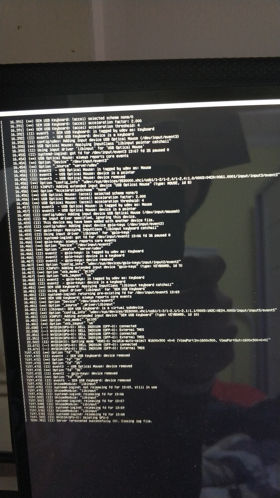

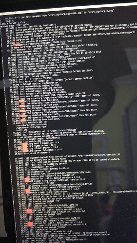

I have uploaded four pictures. That is the content of “Xorg.0.log”

It is difficult to search within the photos. If you use a serial console to cat the log file, then it will log in the serial console on the host. If this is not possible, then look for any modes where you see something like either of these:
Mode "1680x1050_60" is valid.
Mode "640x400_85" is invalid.
The goal is to find out if valid modes are present, and if the selected mode is from that list.
