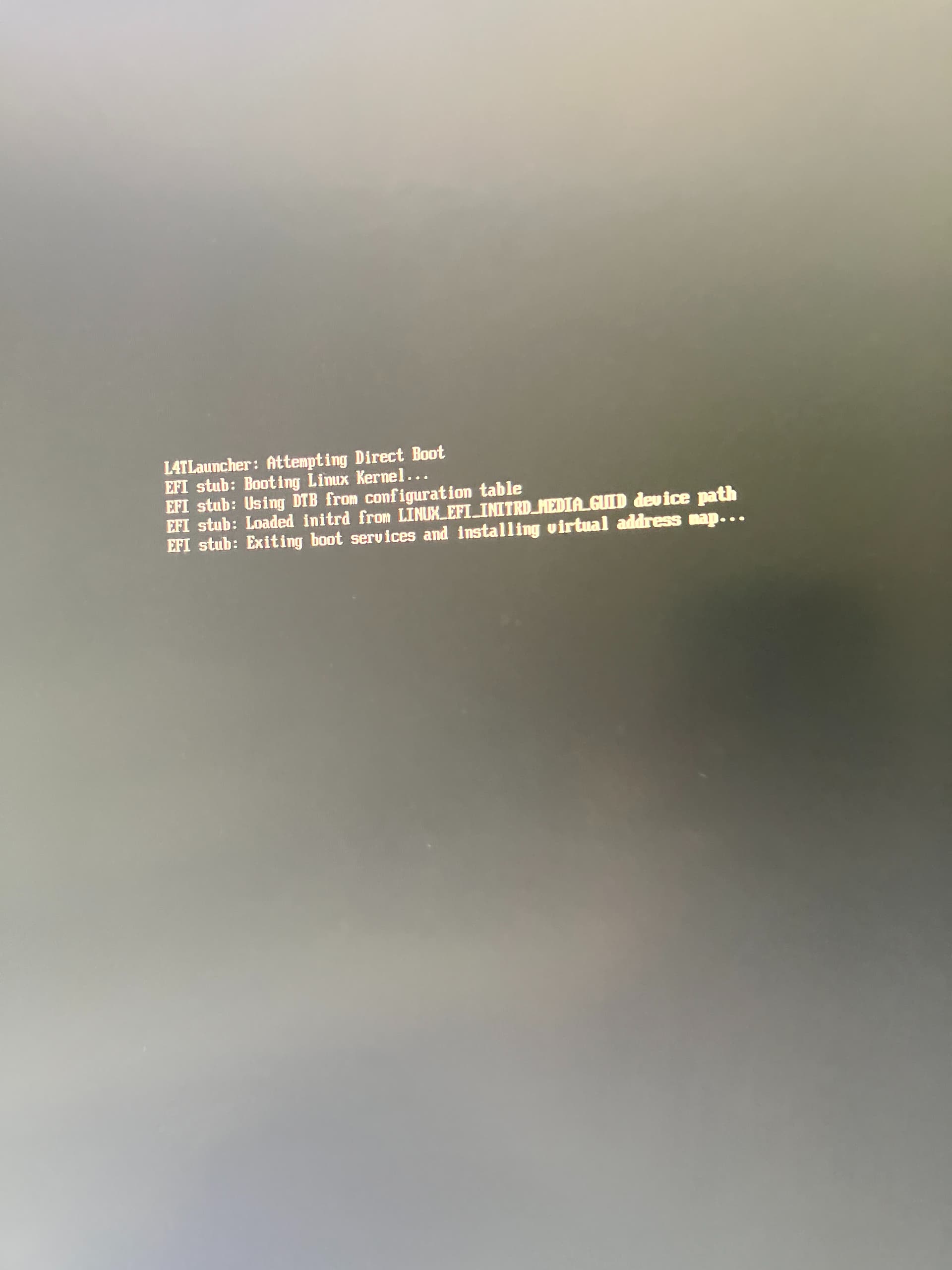

I’m getting these messages and the screen turns off and is stuck. I tried to reflash the sd-card but I don’t think that worked. Would you have any advice?

I reset the device at the setup menu and now nothing comes up just a black screen. The yellow led light is on as well as the fan, just black screen.
Please re-flash with SDK Manager.
